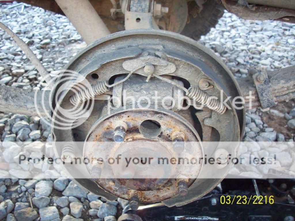

The c-clip is only gonna be on the axles with the smaller 9-inch brakes, which I think they don't have fins on the drums. The bigger 10-inch brakes were used from 1987 to 1989 if I remember right, they have fins on the drums and no c-clips.
The c-clips are on the very ends of the axle shafts inside the diff, inside the pumpkin. Should be almost right up against the cross-pin. But since you have the older jeep, you prolly don't have the c-clips to worry about. So its just swapping the brakes right across just like in the pics above, far as I can tell.

How can I tell the c clip and where in the pumpkin is it located..thankyou
See post # 9. If you have c-clips they will be on the ends of the axles, circled in red in this pic:
