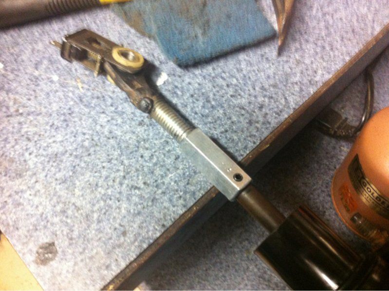

I just yesterday got an 1996 XJ booster and master, looks the same as all the double boosters and is the newer master, $52 at the local pull-n-pay with warranty. I'll be doing the threaded lengthening too. I was originally thinking of just putting the booster on the firewall, like it was in the XJ. But, the clutch master is there and too close, so I have to keep the OEM YJ booster extender bracket and lengthen the booster rod as above.

I reccomend using a a through hole and spring pin to hold the couplinig nut to the booster rod. That way you do not have to weld the on the booster rod and possibly damage the internals of the booster. Since the other end will be cut off you can weld the threaded rod on that all day long.
Edit: here is a pic of what im talking about

Thanks. I wish I knew exactly what the length is of the rod in my '93, and the hole diameter. I'd like to work on getting the new one ready without pulling the old one out of the Jeep just yet, rather just have the new one ready to go on swap day.
