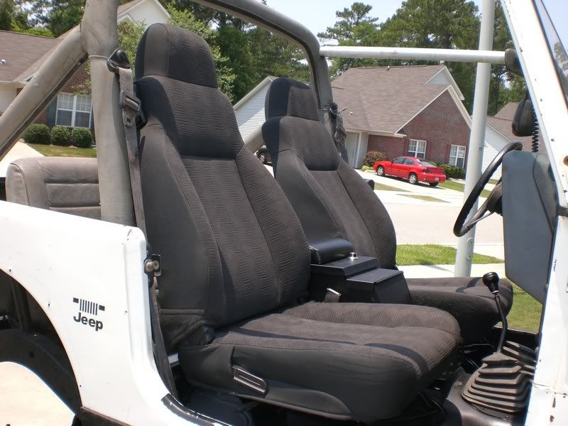

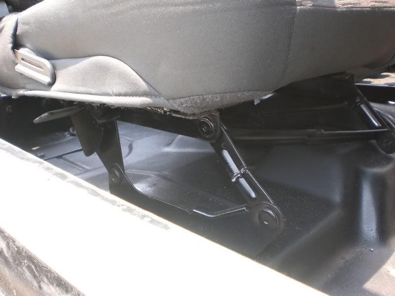

the underside of the rubi seats are much thicker and thus if i mounted them with the sliders to my existing risers they would have been WAY too high. (i would have had to weld, or possibly drill and bolt on)
i opted to ditch the sliders since i could lower them about an inch if i left them off. I wound up cutting the front two vertical supports of the oem yj risers and making them about 3" hole to hole. i also cut the piece that went from one side at the bottom pivot point to the other side on the top pivot point and shortened it about an inch or two to keep the geometry right for the flipping forward function.
in the end i sat the driver's seat where i wanted it and tack welded it in place then took it all off and welded it up real good. then i had my neighbor (who rides with me pretty often) sit his big 6'2" 175 lb *** in the passenger seat and position it where he wanted it and i welded it there.

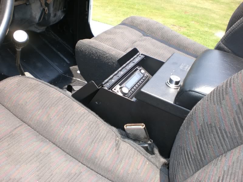

in order to fit the 10" wide tuffy console i had to keep the seats outward as much as possible so the sides rub against the roll bar padding a little when you lean them back far, but not bad at all.

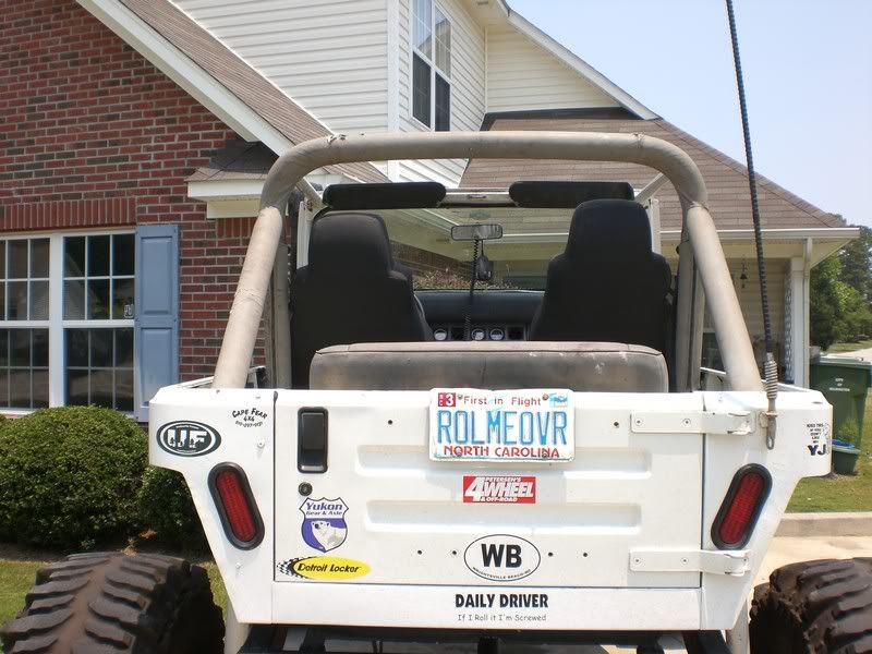

they still sit higher than i remember my yj seats sitting, but it could just be because they have so much more padding. either way, they're comfortable and look great. i couldn't have asked for a more comfortable seat to swap in.... jeep did great designing these bad boys.
if i did it again, or if i get fat or grow 6", i'll cut them off the risers and shorten the risers another couple inches and possible move them back just a hair farther but that would probably make my back seat pretty useless.
-Erik <--- cant wait to get some waterproof black seat covers. this fabric is gay.
