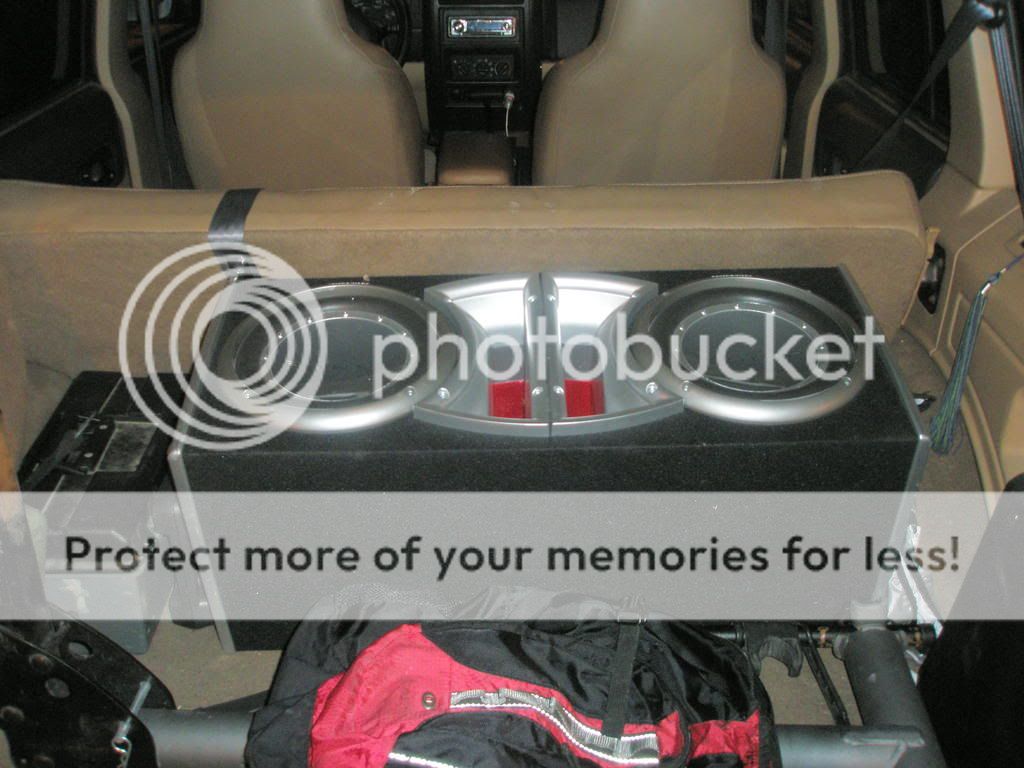

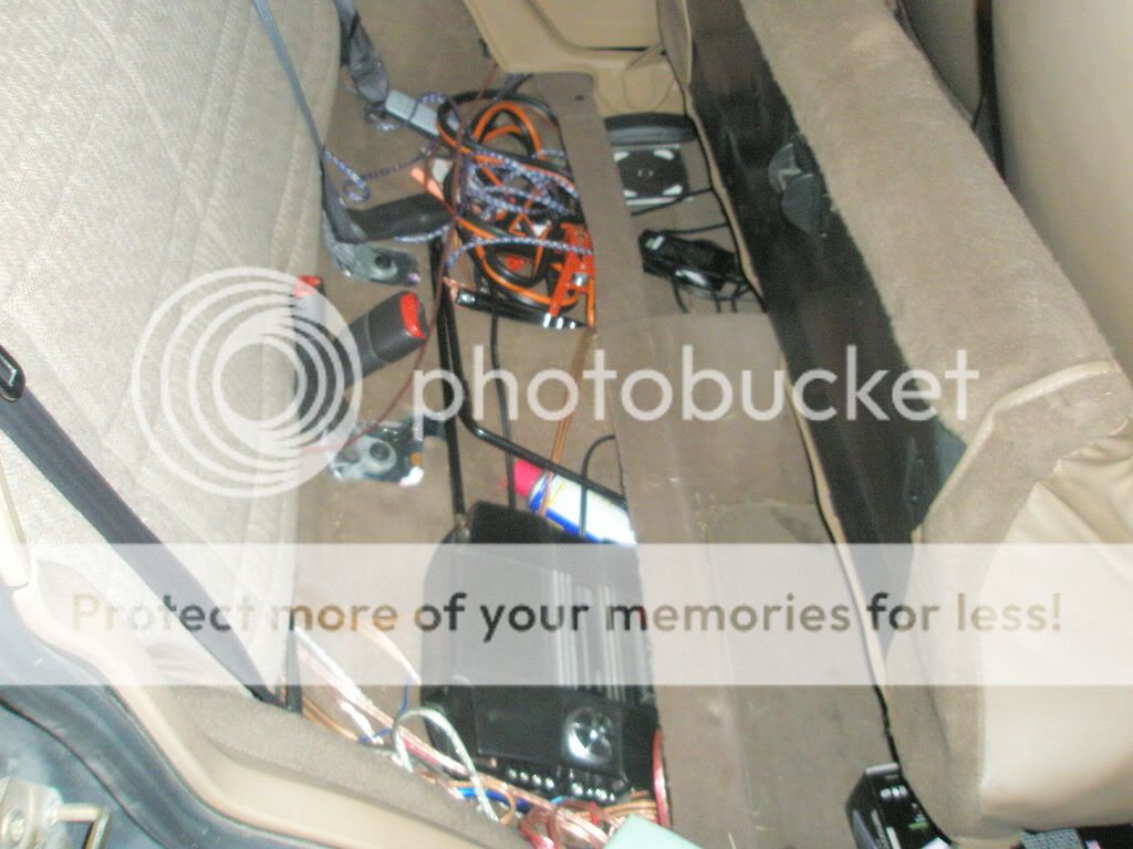

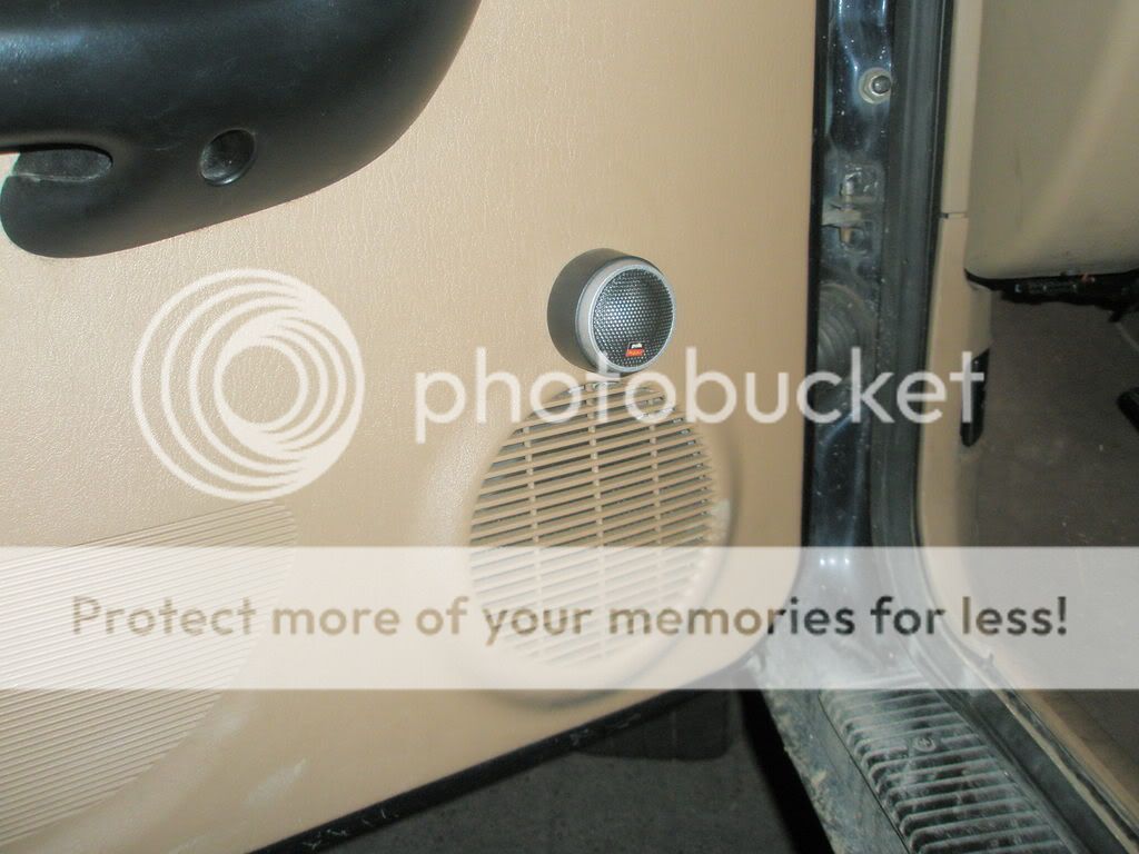

additionally, while I did NOT pull the door panels off in the freezing temperatures in the parking garage last night, but here's where my amps and subs are located, as well as where i mounted my tweeters (havent gotten around to flush mounting them yet.
The subs:
sub amp under the rear bench:
The speaker amp (only visible because the seat is folded down, its hidden between the back seat and the subs):
The door-mounted tweets (i personally like the soundstage it creates):

more pics to come when i have time, space and non-freezing temperatures (or at least a jacket lol), which will be more helpful on the speaker install.
