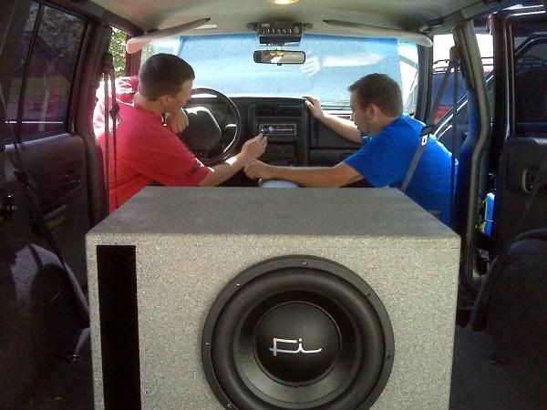

I went up to Stereo Warehouse and got a Pioneer DEH-690UB and 2 pairs of Boston Acoustic SX-55 component speakers. I put an ipod jack in the glove box so I have access to 7000 songs at any given time.
Got ahold of the good guys at Fi Car Audio and had them make me a 12" Q with the full power options. The sub weighs in at 30 pounds on the dot and is a beast to say the least. I also picked up a Kicker ZX1000.1 that is pushing over 1000 watts RMS. Also have all the RCAs, distribution blocks, small wire, fuses, and 60 feet of true 0 gauge wire.
I got a ZX350.4 for my component speekers but im not sure if I want to wire it up since it will be a pita to rip out all the old wire and run all new wire.
A local guy I am buddies with, and who has a system pushing 150dbs, is currently building me this box custom for the sub.
2.5 cubic feet tuned to 33hz. 24'' wide x 15'' high x 19'' deep. 2.5'' wide port, port painted black, box painted speckled grey, and 33.75 inches of port area. Wood is 3/4" MDF.
Box all completed.
Mock up
glue sides
painting port
masking port
painting outside
more paint
Finished. The textured paint looks very cool in person!
Gutted and ran all 0 gauge

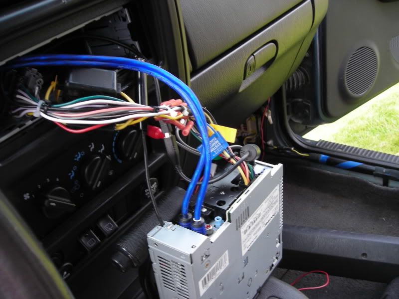

Last night I finished installing the stereo stuff. Lets just say overkill is an understatement.

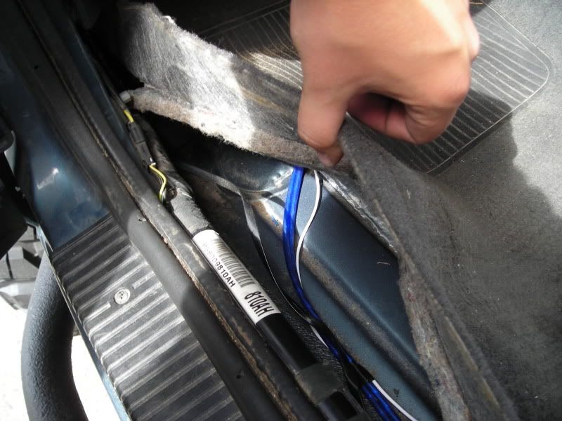

I ran all the wires under the carpet all the way back. All wires are hidden, very clean isntall.
Soldered all the wires, no crimping

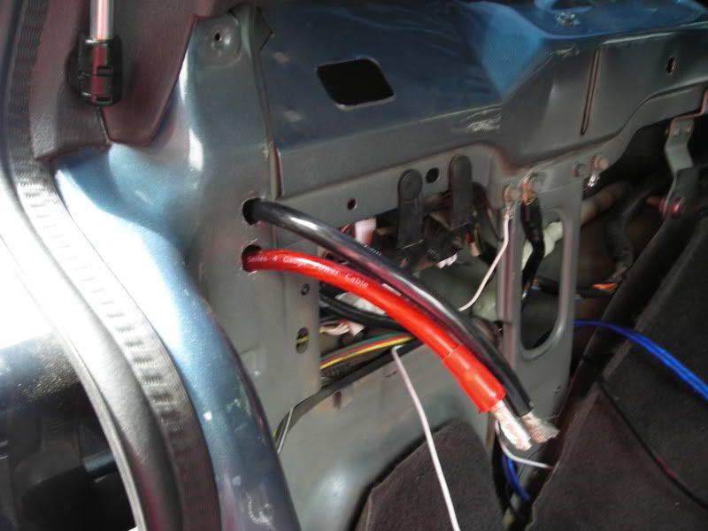

Drilled holes for the power wires on drivers side

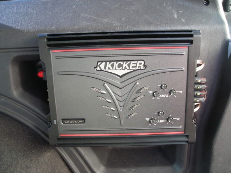

Kicker ZX350.4 wired up

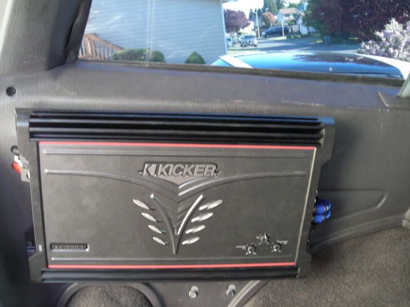

Kicker ZX1000.1 wired up

Please tell me you put some grommets around those power wires after you took that picture. Otherwise those nice sharp holes you drilled will soon cut thru the insulation leading to the possibility of a nice electrical fire for ya.

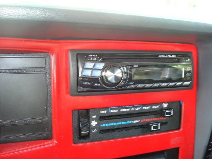

Here is my alpine head unit, got it for free when my kenwood took a dump.

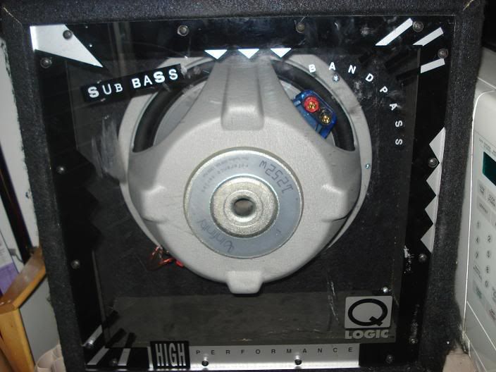

My horrible subwoofer and my crappy wooden storage box, like the spray paint?
Double sound bars with some pioneers, powered off the headunit so you know they sound sick.
This is my baby but im too poor to replace my amp with one that will actually power this monster. It was a beast when i had it up and running, have a horrible capacitor where the allen screw stripped out and caused me to touch the positive and negative with the allen key, bye bye best amp.
Im down to 1 200 watt crappy amp which i originally used to power 1 set of speakers. had 2 amps for the speakers and 1 600 for the sub, too poor to replace it.
I hate my subwoofer.

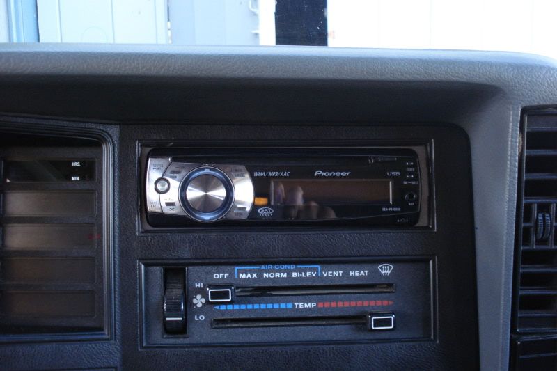

lol bad choice on the Head Unit..ive got an pioneer 4000 and absolutely despize it and wanna smash it. You will know what im talking about when you start listening to your 7000 songs. Ive only got 2000 and wow i wanna pull my ****ing hair out.
Oh and btw the best sub and port config for a SUV is sub up port back. Sub up and port up is also very good in a cherokee. And i commend you for going with Fi subs...at least someone on this forum has a clue about real car audio.

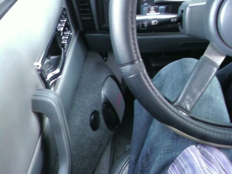

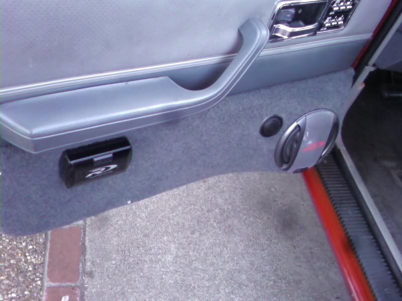

Here are some pics of my system, ive got a temp sub setup for now but iv spent a lot of my audio money on my volvo so thats gonna be on hold for a bit.

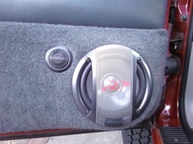

some door pods i made from fiberglass:
alpine for highs:
pioneer 4000..hate it:
$30 HiFonics subs, HiFonics 1000 watt amp, 0 gauge wire (not shown in pics). The box is now ported tuned to 35hz for each sub:
A-pillar speaker pods comming soon
I like it actually. I just create playlists with about 150 songs each with a different theme so I can play depending on my mood.
