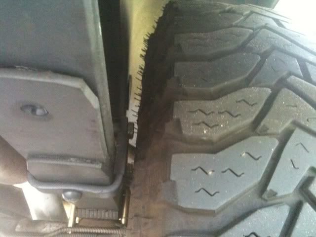

Originally Posted by alexrule123 View Post
Even with 10.5s this is how close my tires are to the leaf springs.
What wheel/tire set up is that? Those have to be stock wheels? No?
Yes they are stock wheels with a 10.5" wide tire
How bad to they rub the lca's ? Or did you modify the steer stops?
Yes they rub the LCA at close to full lock but my longs arms will fix that
