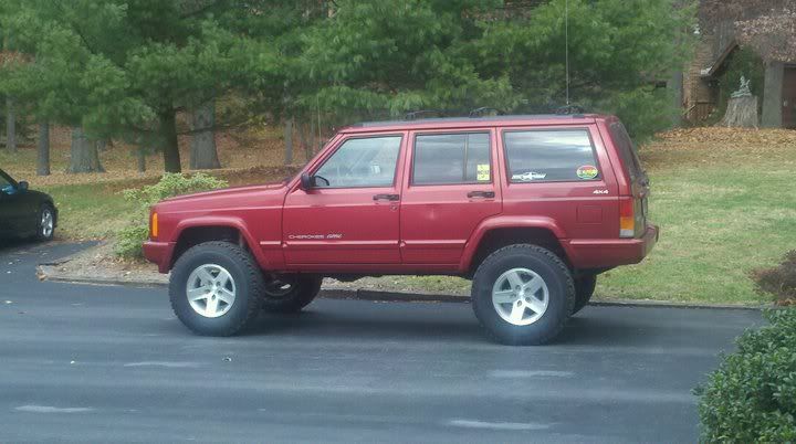

RE 3.5 Super Ride with 32s:
Trimmed the front fender trim only. Haven't put the bumper caps back on yet.....they will need some extensive trimming.

Rig looks awesome Will951. I think I'm gonna stick 31x10.5 on mine but i haven't decided on wheels yet. I like how DC-2 rims look but I'm unsure about the 3.6" BS. Cragar Soft 8's are also another option im looking at. I would like a wider stance but i dont want to overdo it where itll cause problems. The Super ride kit suggest 4"-4.75" BS on 8" rims. Is it better to run 8" wide rims on 10.5" wide tires? Any thoughts?
