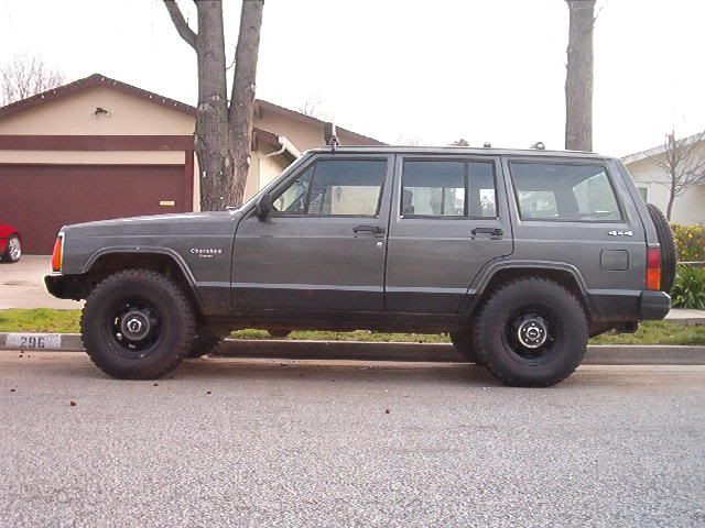

After countless times of me looking through the lift setups....I finally get to post mine
1987 Cherokee Pioneer
Front: 2" coil spacers
Rear: Black Diamond 2" AAL
KYB GR2 shocks (stock lenght)
30x9.50r15 Kumho MT's
Stock wheels
No trimming needed for the 30's, but I'll be going up to 31's soon, so I'll be trimming up a bit.. Very happy with the kit, no vibes. Spent $107 total, shipped. The AAl kit came with new centering pins and 3 spring clamps per side. AAl rides stiff though, but I was expecting that anyways. Took 2 ppl, myself and friend, 4 hours and we ran into a few problems along the way. Driver side was a pain, and I had 5 stripped lug nuts.
And now for the pics
Before
After

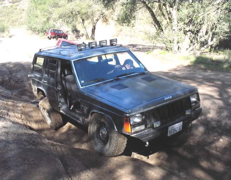

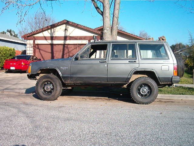

tvisXJ
Join Date: Oct 2005
Location: Marin Co.
Posts: 1,265
2" BB
Front: 2" Coil spacers
Rear: 2 leafs swapped in from S-10 pack.
2nd leaf in S-10 pack used as AAL, 3rd leaf in place of stock XJ 2nd leaf.
Updating to show 31"x10.50 BFG AT's... and lift updates.
a little action pic
