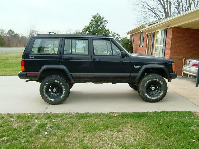

2 inch lift
4.5 inch lift, 31 10-50 TA KO's

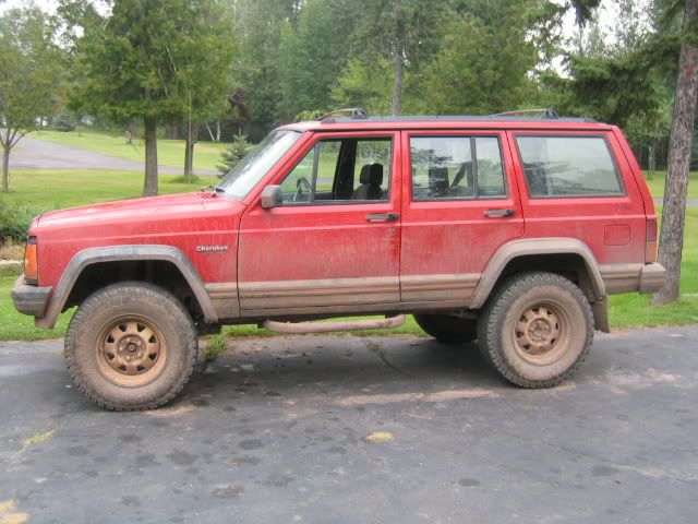

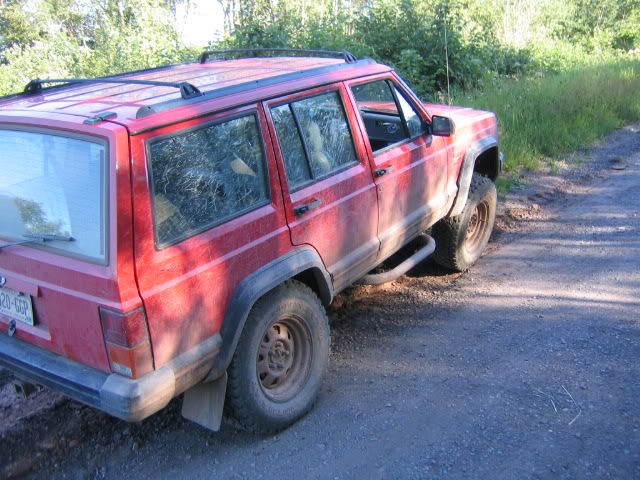

1993 Xj Sport
Year: 1993
Lift kit:4"springs in front,s10 pack in rear
Shocks: front 24inch monroe somthing or other rear 26" monroe
Tire size: 31x10.50x15 Continental Sportiva At (actual 30.5)
Wheel size & backspacing: stock rims with stock backspacing
Notes: Rubs on lca at full lock and on front fender flares at full stuff.
