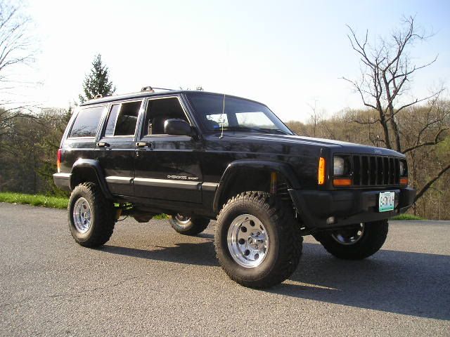

Year/Model: 1999 Sport
Lift: Rubicon Express 3.5" Super Ride w/ full leaf packs
Shocks: Old Man Emu NitroChargers
Driveshaft: Rubicon Express SYE + Tom Woods CV driveshaft
Wheels: American Racing "Baja" 15x8 Alloy
Tires: 31x10.50 Pro Comp M/Ts
Axles/Gearing: HP30 (front) + C8.25 (rear) w/ stock 3.55 gearing
Extras: Teraflex swaybar disconnects, removed rear swaybar, Tereflex adjustable track bar, C4x4 front tow hooks
Pics:
Link to the other pics:
http://photobucket.com/albums/v299/FocusZX3Rules/Jeep%20Pictures/
--Dan.
1999 Cherokee Sport - Black; 4.0L AW4, NP231 w/ D30 and 8.25C.
RE 3.5" Super Ride w/ full packs (4* shims) + OME shocks + RE SYE w/ Tom Woods CV
Yukon 4.10s
AR Baja Alloy Wheels - 15x8 + Bridgestone Dueler Revo A/Ts - 31x10.50x15
TeraFlex Adj. Trackbar + TeraFlex Quick Disconnects & WARN T-case skid

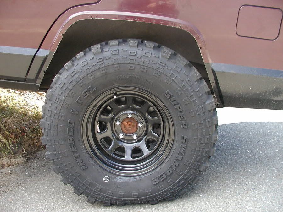

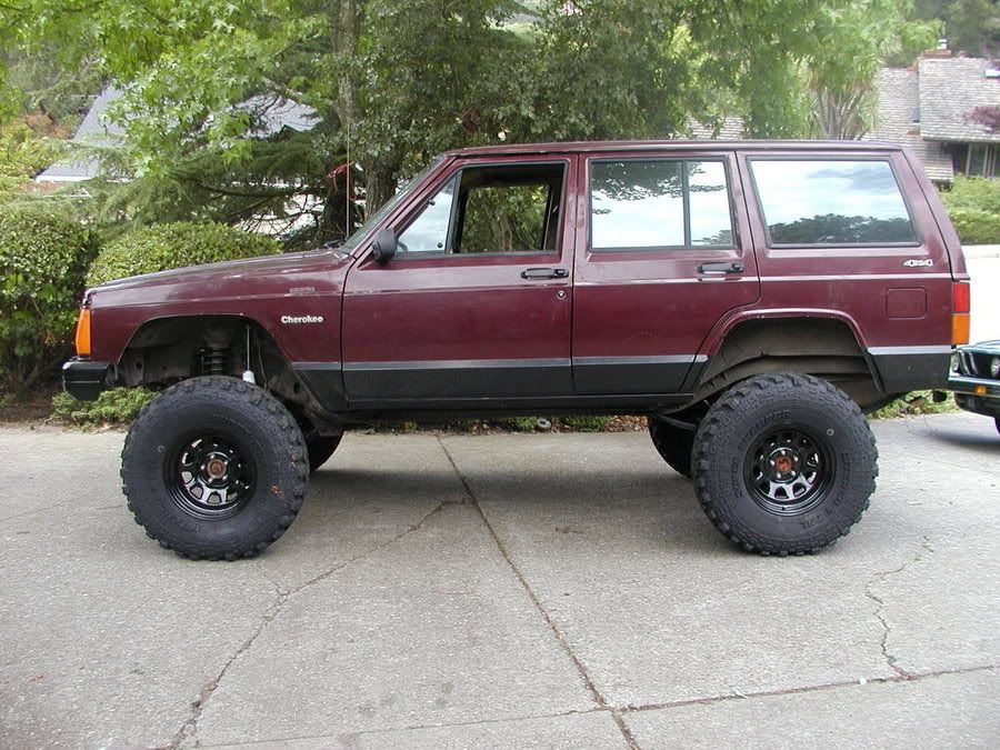

Year/Model: 1993 country
Lift: Rusty's 4.5" with full leaf packs
Shocks: Rusty's reccommended for 4.5" of lift
Driveshaft: AA SYE and some woods cv driveshaft
Wheels: 15x8 Black Rockcrawler w/ 3.75" backspacing
Tires: 33x12.5r15 super swamper tsl radials
Axles/Gearing: front HP30 w/ 4.10's + ford 8.8 w/ aussie locker and 4.10's
Extras: No rear bumper. No swaybars. Painted lower trim/front bumper black. Relocated the horn and vacuum canister inside the engine compartment.
Problems: Slight vibes due to wrong ds angle (welded it with the pinion facing to far up ) so i will have to use shims, but backwards... Old ebrake lines hit the ds. I will have to find a way to remove it. Rusty's rule!
I trimmed both the front and the back. Stock bumpstops. Front does not rub at all. The back fender slighlty rubs at full stuff (see picture)
