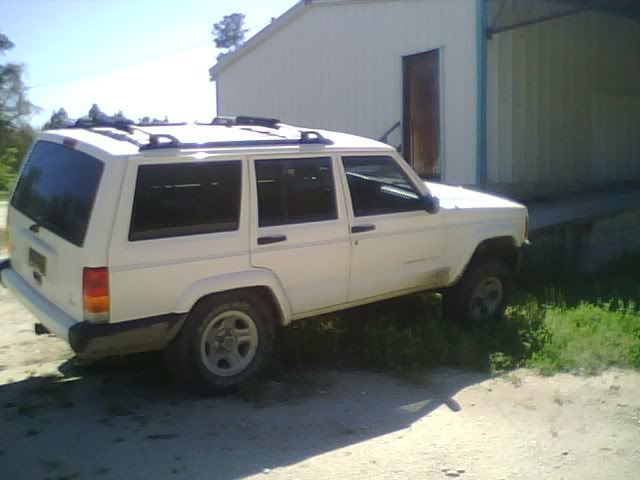

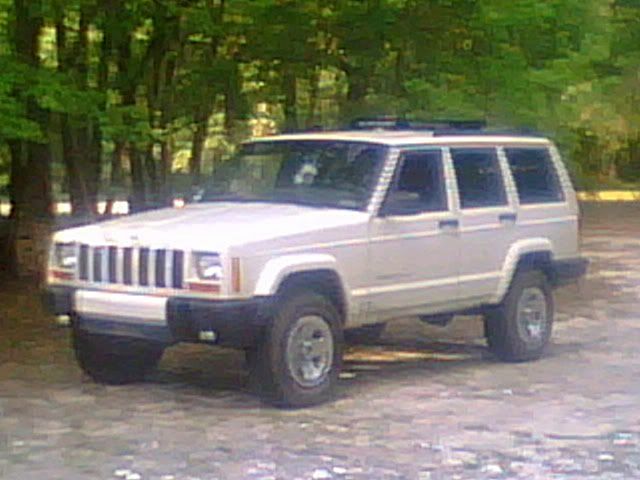

post #453 of 495 Old 04-26-2009, 08:58 PM
jccJeep
2007 WK
Location: NC
Posts: 796
Year: 99
Lift height (listed & actual): Rusty's BB 2"F 2.25"R
Shocks: stock
Tire size: 235/75/r15
Wheel Size & backspacing: Stock
Notes: No trim. Cell Phone pics

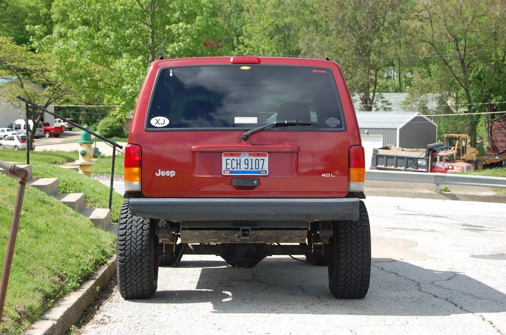

post #456 of 495 Old 04-28-2009, 10:28 AM
thall430
1997 XJ Cherokee
Location: Michigan
Posts: 10

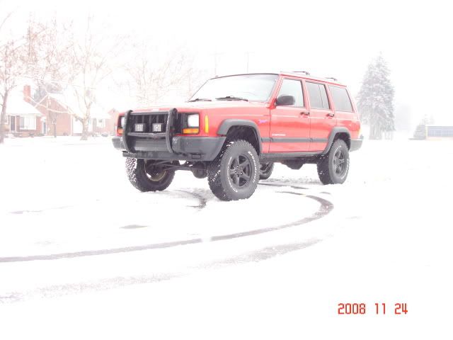

Big Red Begins
Year: 97
Lift: 3 inch Skyjacker
Shocks: Skyjacker Hydro 7000
Tires: BFG A/T 31 X 10.5 X 15
Wheels: Eccos painted black
Notes: Quick disconnects, custom t-case drop, NO Vibes!, rubs on HARD turns, Steering stabilizer & 1.5inch shackles sitting in my truck waiting to be installed.
http://s254.photobucket.com/albums/h...t=DSC02195.jpg

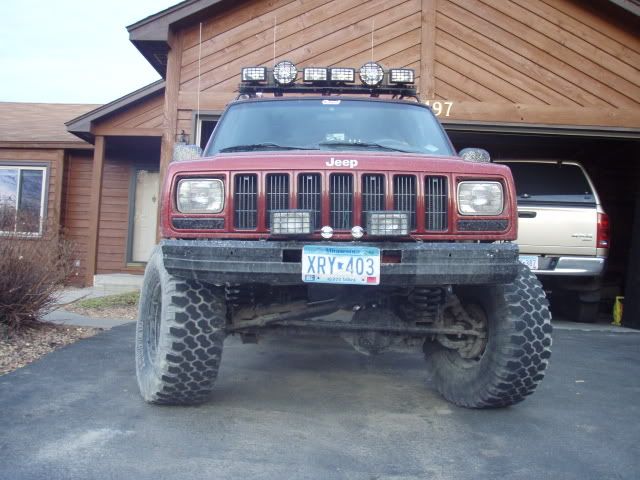

1999 cherokee
4.5" of lift = 5"
33x12.5" coopers
trimmed front and rear..rubs on front fender fully flexed out steering either direction with no sway bars

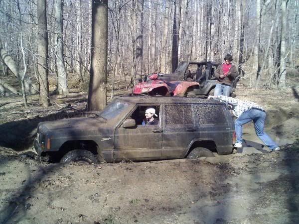

post #460 of 495 Old 05-04-2009, 05:05 PM
Xdukeofd
1997 XJ Cherokee
Location: brick
Posts: 8

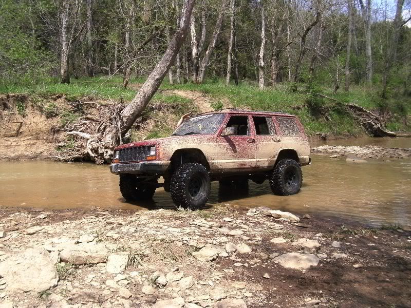

1997
4.5" RC w/ 2 inch blocks in rear
RC shocks
31" x 10.5 Goodyear Wrangler Silent Armors
15x8 American racing rims
Notes: 33" x 12.5w x 15 mud terrains soon..
<a href="http://s57.photobucket.com/albums/g234/XDukeofD/?action=view&current=mudschool.jpg" target="_blank"><img src="http://i57.photobucket.com/albums/g234/XDukeofD/mudschool.jpg" border="0" alt="Photobucket"></a>

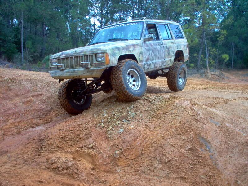

Just got some 35s but havent got them on yet. Read sig for the set up
92 XJ 6 1/2 RC lift plus 2in BB, 35x12.5 Mud Rovers m/ts Aussie front D30 and Powertrax locker C8.25 rear, Rusty HD steering, RC control arm drop brackets, Nates rear bumper, HD SYE, YJ brake lines, Transfer skid plate, Nates slim line front bumper, Smittybilt XRC-8 winch, converted A/C to onboard air, Rino lined Floor boards

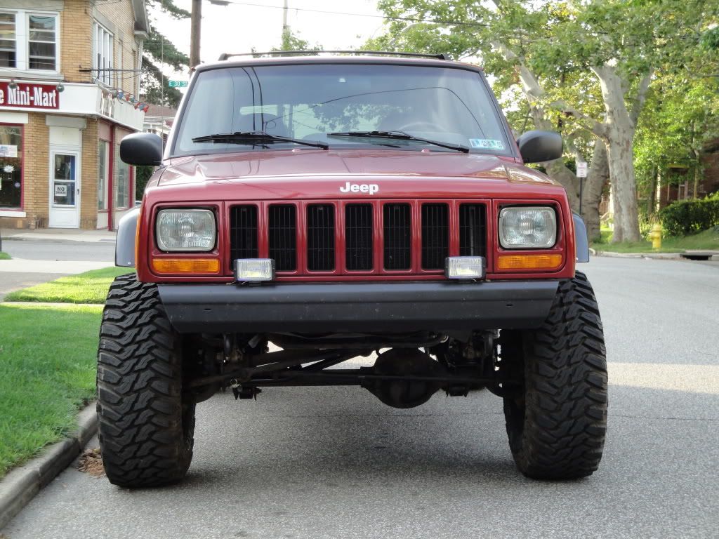

98 xj sport
3 RC with 1.75 coil spacers and RC adj shackles
RC sway bar discos
33x12.5x15 micky thomson baja claw radials
15x8 w/ 4" backspacing
RC shocks, needs longer ones, still running the ones set up for 3" of lift
trimmed fronts, cut and fold in the rear.
aal suck, rear sagging about an inch

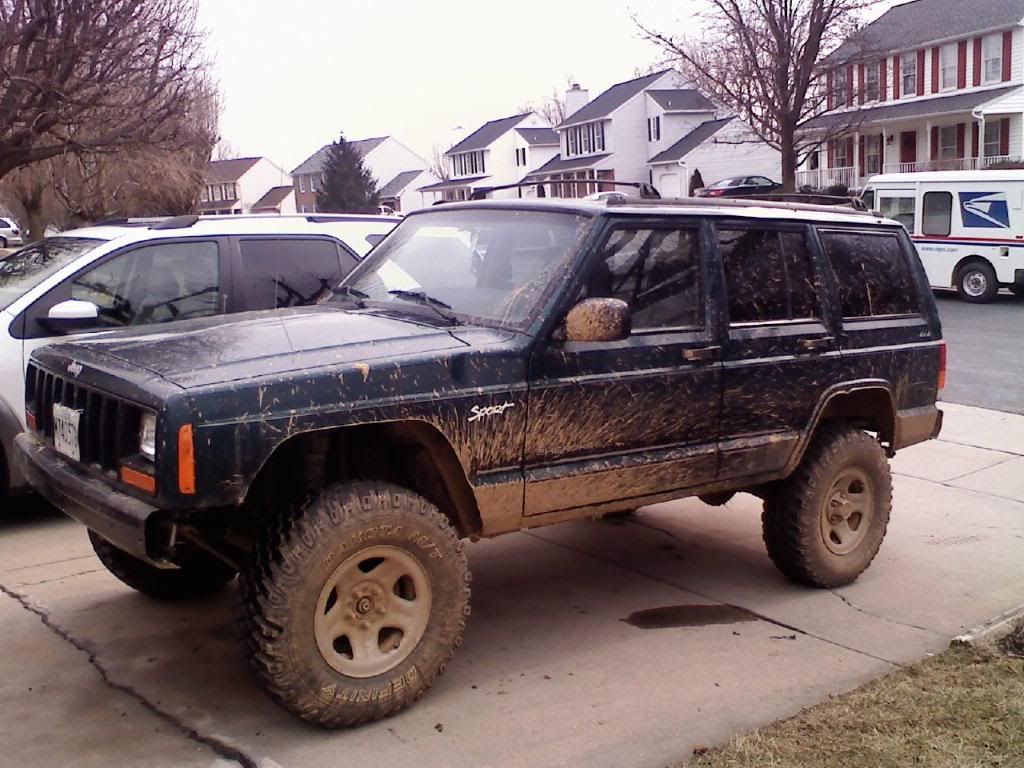

1998 cherokee sport
4 inch homebrew lift
31 inch defintiy dakota m/t
stock 15x7 wheels
notes: front fender trimming about 2 inchs for full flex, added front fog lights, needs new front shocks they blew out
