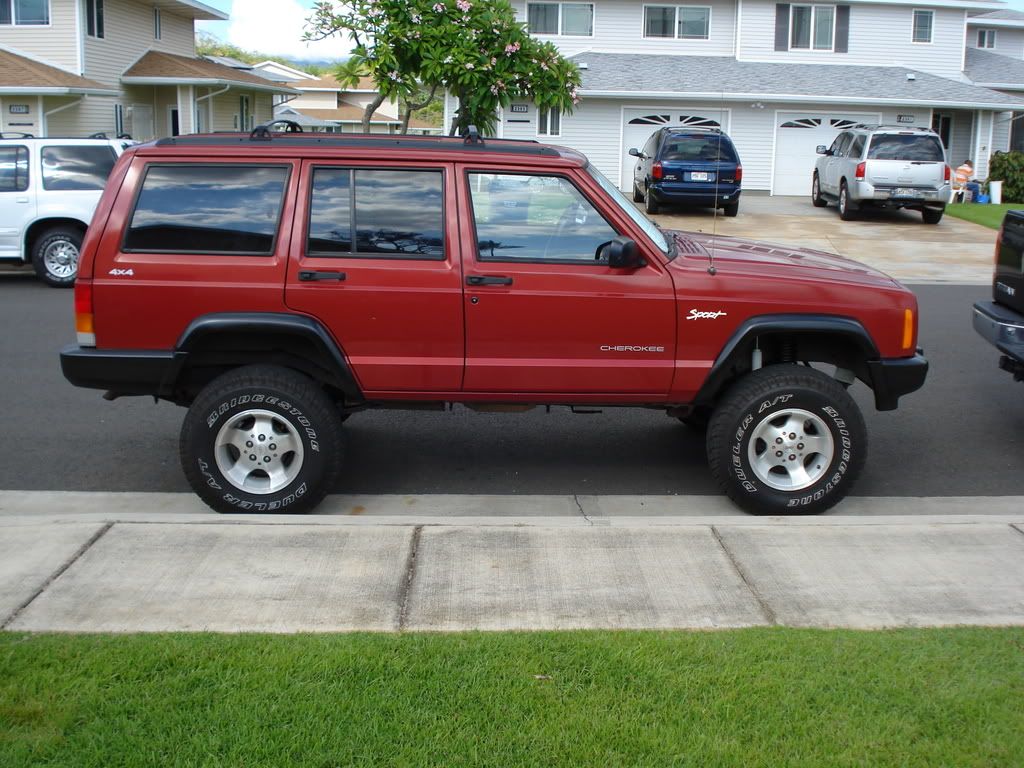

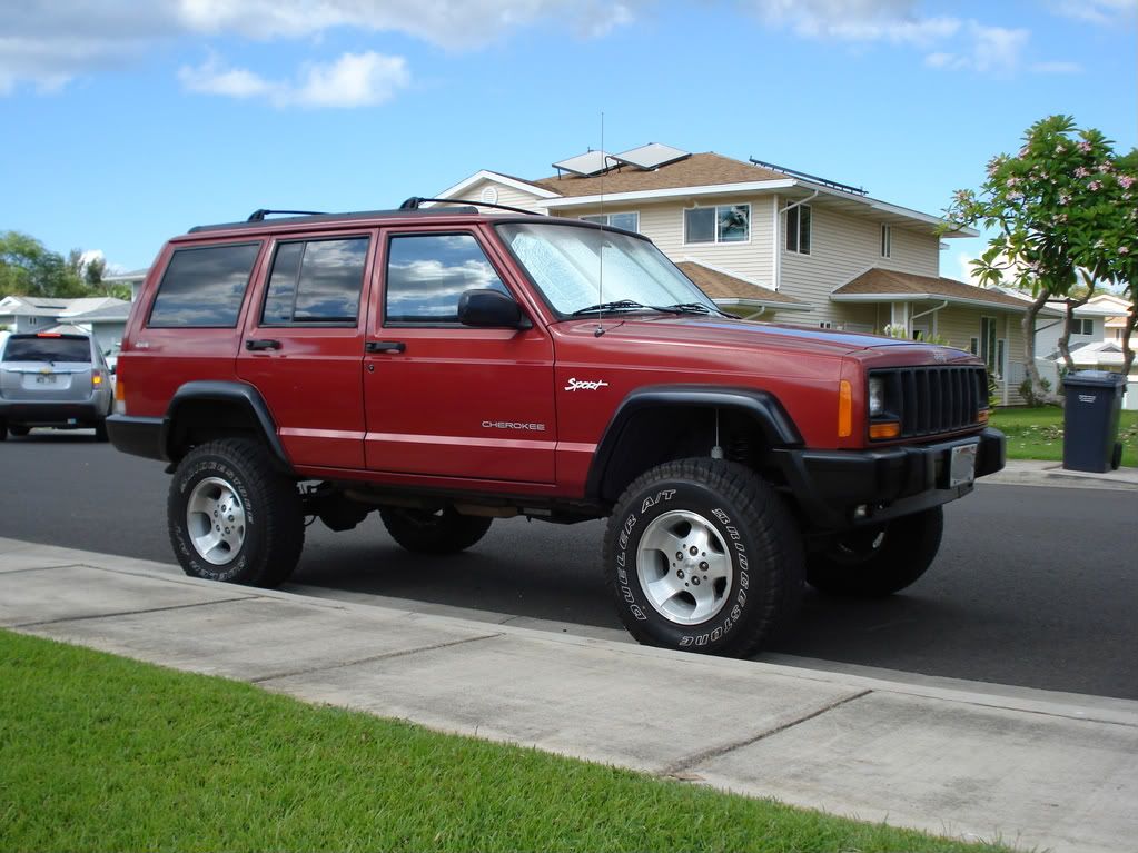

Year: 1999 XJ Sport
Lift height (listed & actual): RE 4.5" / 6" netted
Shocks: RE Monotubes
Tire size (Listed & actual): X-Terrains 33x12.50, 32.2"
Wheel Size & backspacing:15x8, backspacing not sure around 4"
Notes: Gonna be trimming asap and got ot regear soon too, 3.55s suck.
Sorry for the parking lot pics, just finished lifting hours before and yeah its on a slope.

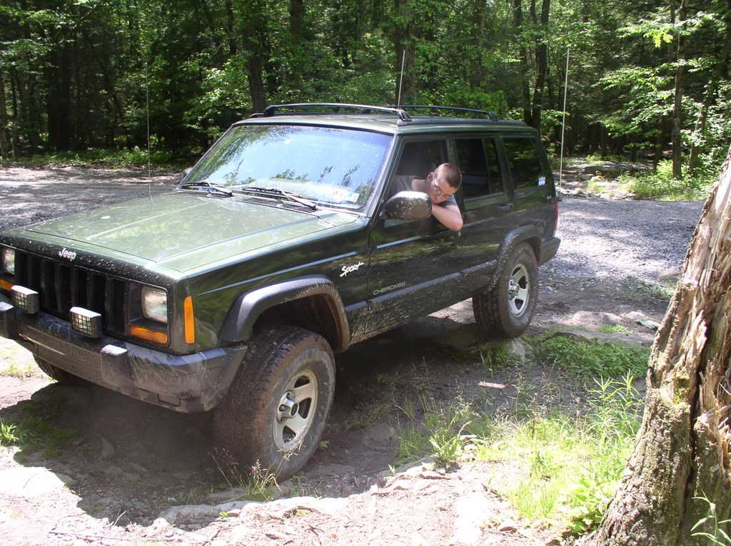

post #305 of 495 Old 06-02-2008, 05:48 PM
YJroks
Location: pennsylvania
Posts: 49

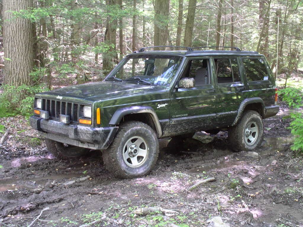

Model:1998 Moss Green Cherokee Sport
Lift:2" BDS Add-A-Leaf Kit
Shocks: BDS Gas Shocks
Tires: 31x10.5 R 15 Uniroyal Liberators
Wheels: Stock Steel wheels, no backspacing
Notes: rubs at full steer and stuff. no rubbing in flexed picture. very happy with lift!
http://s306.photobucket.com/albums/n...t=P1010093.jpg
http://s306.photobucket.com/albums/n...t=P1010081.jpg

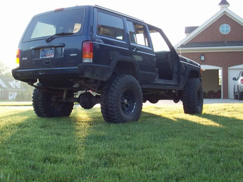

Year: 2001
Lift: 6.5" Hybrid/ TnT Customs Longarm Kit
Lift height: 6.5" listed, 6.5" front, 7.0" back
Shocks: RE Twintubes (for 3.5" kit, havent gotten longer ones yet)
Tire size (Listed & actual): 35" Maxxis Bighorn M/Ts
Wheel Size & backspacing: 15x8 Cragar Soft 8s 4" BS
Notes: I did Rock Krawler 6.5" coils up front, 1" U-bolt Eliminators, 1" Shackle, 3/4" lift from 8.8" tubes, 3.5" RE packs

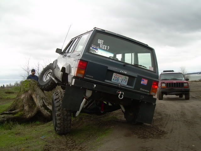

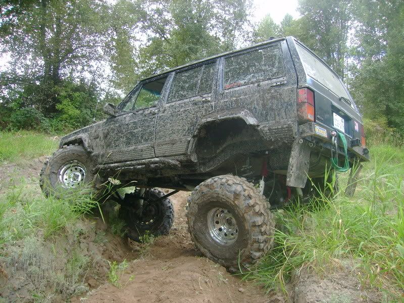

post #312 of 495 Old 07-07-2008, 11:59 PM
ROCKIN-XJ
1989 XJ Cherokee
Location: vancuover wa
Posts: 3

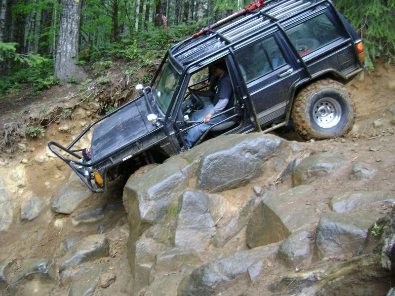

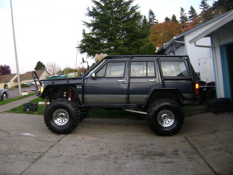

1989 xj
4.0l low output
8inch total lift
long arms front (home brewed)
4 linked rear (home brewed)
ford 9 inch rear w/ lsd
dana 30 front w/ lock rites (junk)
custom front and rear bumper
custom rock sliders
custom tube doors for the summer
custom exo cage (home brewed)
sye w/ a tom wood shaft
36 inch super swampers tsl
