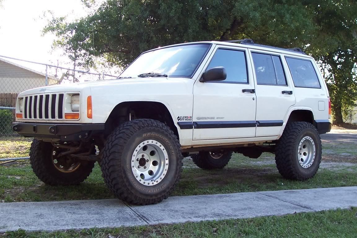

Ok new setup.........
32x11.5 BFG MT's on MT fake beadlocks(they look real)
Chevy Blazer leaf packs
ZJ V8 coils with teraflex 2" spacer
RE TC drop

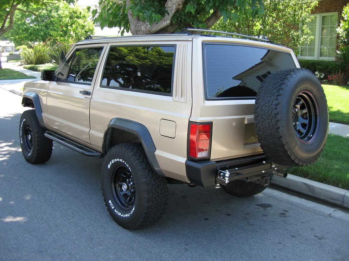

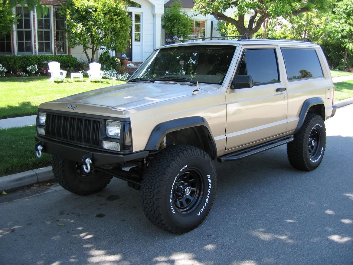

Smile Update!
Update from last years post
Year: 1989
Lift Kit: DPG/Rubicon Express- 4" Extreme Duty Hybrid XJ Cherokee Kit
Shocks: OME LT
Front Coils: RE3.5 inch with 3/4 spacer
Rear Leafs: Deaver Jeepspeed
Front Diff: Dana 30 with 4.11 gears
Rear Diff: Dana 44 from 87 cherokee and 4.11 gears with trac-loc
Wheels: AR 767's 15*8 with 4.5 bs
Tires: BFG AT KO's 32*11.5*15
ACCESORIES: JKS BPE's, JKS ADJ Trackbar, JKS Q disconects, DPG ADJ Bumpstops, DPG Disco's, War Diff armor, C4x4 RB with TC, JCR STG 3 FB, AJ Super Rails.
