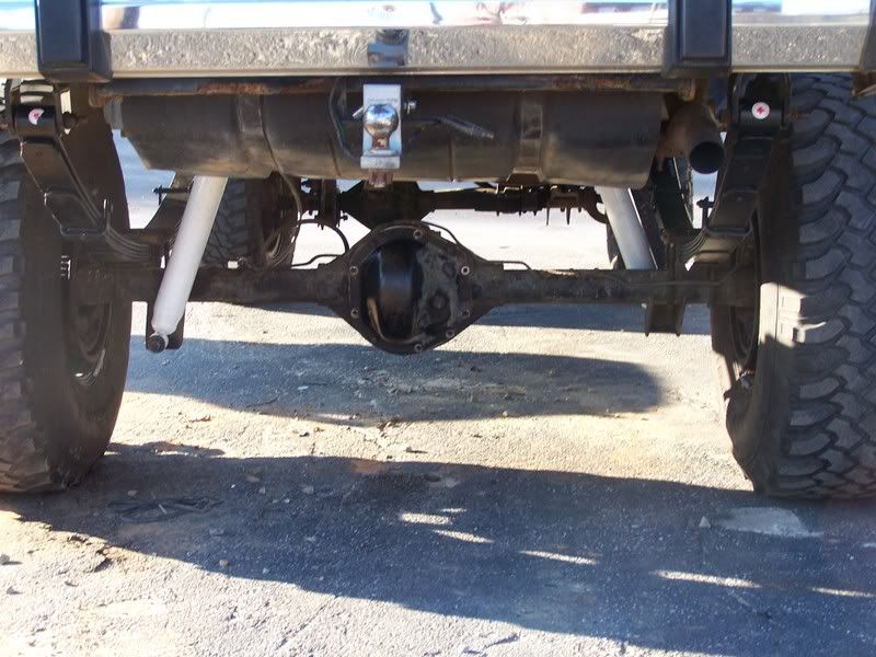

pic of d44
This is what it should look like

60 - 61 inches from the wheel mount surface to wheel mount surface on the brake drums. Leaf spring pads and shock mounts like in the picture. 44 inches from the center of the leaf spring pad to center of the other leaf spring pad.
