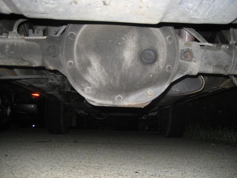

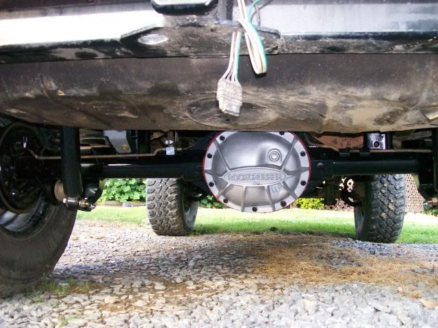

This is the dana 35, notice it has no housing showing under the diff. cover and the cover is completely oval. This is the 8.25, notice the flat section of housing underneath the diff. cover and the raised lip around the cover.
