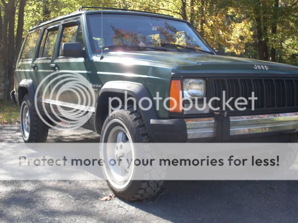

My dad has a '90 Cherokee that has definitely been worth every dime he originally paid for it. But through the years and many hard miles (almost 300,000 actually) it has taken some wear and tear. So this past summer he started to think that it was time to get another jeep to replace it. After much debating however, we decided that the jeep that has served us so well, still had more life in it. So instead of turning it into a full time plowing machine, we made it our weekend fixer-upper project.
We began by sanding every inch of the body smooth, filling dents, repeating multiple times, then applying primer.
After that, we decided to change the color from a very dull grayish-blue into more of a forest green. We also decided to ditch the chrome and trim the jeep in black.
After many devoted weekend hours, we have the exterior nearly finished. In addition, we replaced every light bulb, including headlights, replaced the rear bumper, restored the wheels, installed a 2" skyjacker lift with steering stabilizer, and put on some meatier tires.
It's been a blast fixing it up together so far and we have future plans to redo the interior next. I value fellow member opinions, so what do you guys think so far? What else could help breathe some fresh life into this jeep?

Well, I wouldn't have fixed the dents, but the new paint looks mighty good.
Now it needs nothing but what you need to make it do what you want it to do........

Nice work on the body!
How about under the hood? A compression test is always an interesting "snapshot in time" of the internal condition of the engine. Looking for about 120-150 psi with no more than a 30 psi variation between cylinders.
Tuneup hardware fresh? Plugs, wires, cap, rotor?
All fluids fresh? Cooling system up to snuff including new hoses?

I'm digging the forest green. I'm not a huge fan of trim but to each his own
Any plans on freshening up the chassis after the interior's done? Wire wheel and bedliner?

I think it looks great. I'm not a fan of chrome so the blacked out trim looks good to me. The only thing I don't care for is the whitewall tires. Keep up the good work it's paying off.

It looks great! I can't decide if I like the white walls or not. It kinda gives it a classic look. Very clean. Glad you decided to fix her up and save her than let it turn to junk.
