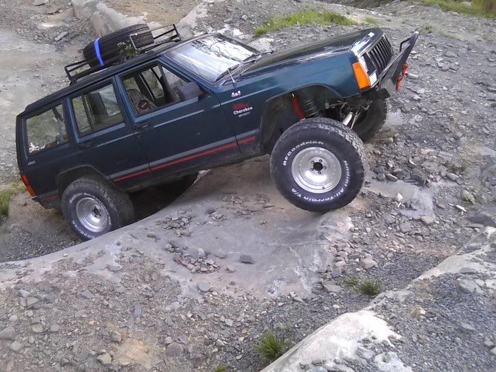

What color of green is my cherokee
So i wana get new fenders since mine are mutilated and paint them but im not sure what "shade" of green my cherokee is , anyone know off hand
Old picture but the color hasnt changed lol

The color code is listed on the white info tag on your drivers door. The code can be Googled or you can find the paint color name at www.paintscratch.com
You local autobody supply shop can mix you any quantity of paint using the color code.

Well, whatever color they were in '95, they aren't that now. I've had pretty good luck getting the local autoparts/autopaint store to use their paint-matching device to match my 16 y/o green paint. They'll mix up a spray can pretty reasonably. Just a thought.

Jeep had two greens in 96, and I think in 95 too. The most common was Forest Green and the other was Emerald Green Pearl Metallic which is the color of my XJ. The paint code is your best bet to get the right color.

i'd say 45%green 55% blue. just look on the drivers door it should say.

So why is the paint code the best for a match? Obviously after 16 years in the weather the rest of the vehicle will be a different color than a body panel newly painted with the original color.
