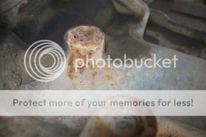

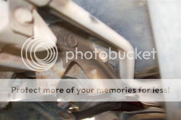

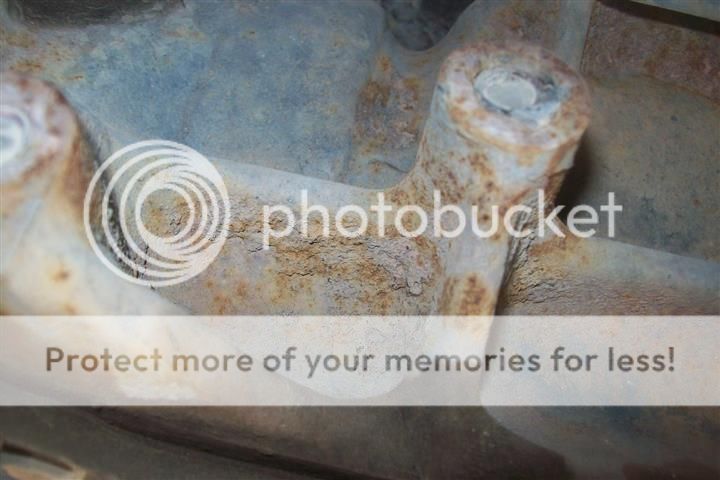

chalk up another victim...my Dad inherited a '95 4 x 4 and drove it over 2 hours from UP IN THE 'STIX with sheared bolts. He mentioned that he thought it had a bad mount! After I couldn't install a fan shroud and new fan, then measured from the bottom of the radiator to the centerline of the hub that the fan bolts to, we realized something was very wrong. Dad then noticed that looking at the valve cover, the engine seemed tilted, so he got under and saw the 3 sheared bolts. 2 are sheared about flush (see pix) but one isn't but the threads don't look great; on that one, I believe the bolt broke further in. We will hit them with PB for a few days and see if the reverse drill thing works. We also have a welder friend coming to weld the upper driver door hinge so maybe he could get in there and weld a nut to the broken bolts...Brown Dog mount may be the solution here. Gotta smog it first,
