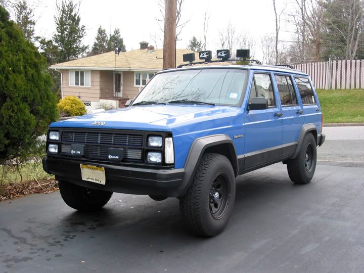

so im debating on my front end makeover. i was thinking of goin 97+ body style. but now im debating a waggy conversion. i photochopped mine to see. personally ive never seen any one with a blacked out waggy grill and clears. id try 3 h4 bulbs or similar to it as well. so if you guys know any write ups on a conversion or just the set up, i'd appreciate it. thanks

heh, and those stains on teh driveway have been taken care of. no mo leaks....for now

so the headlight harness and i guess the headlight sockets as well is all i need besides the grill and headlight bezels. and also what is the two squares next to the lower headlights for? is that for the parking lights? and also i can get away with the same header piece from a pre 97 xj right? or is there a waggy specific header piece? (i looked on ebay and they seem to be the same)

Yes, I do believe those are the front marker lights. Recessed behind the grille. The header should be same.
But when you go, I would just pull the whole thing. There are only like 4 bolts holding the entire front fascia on. Pull the whole thing and then it should bolt right up to yours.
