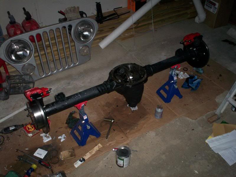

That's a nice looking 8.25. How did you prep it (sand it/paint, etc.)?

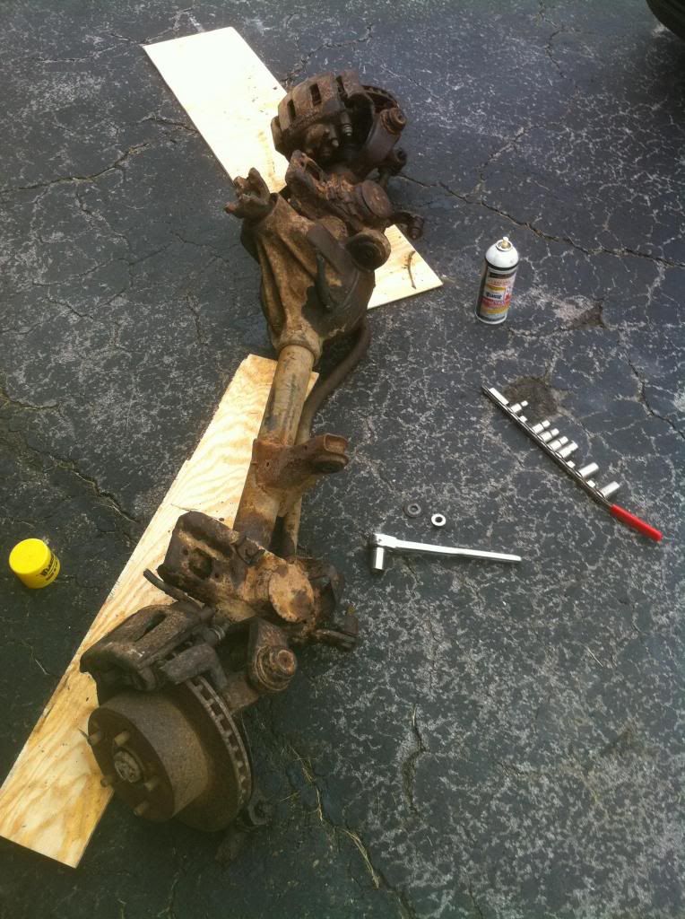

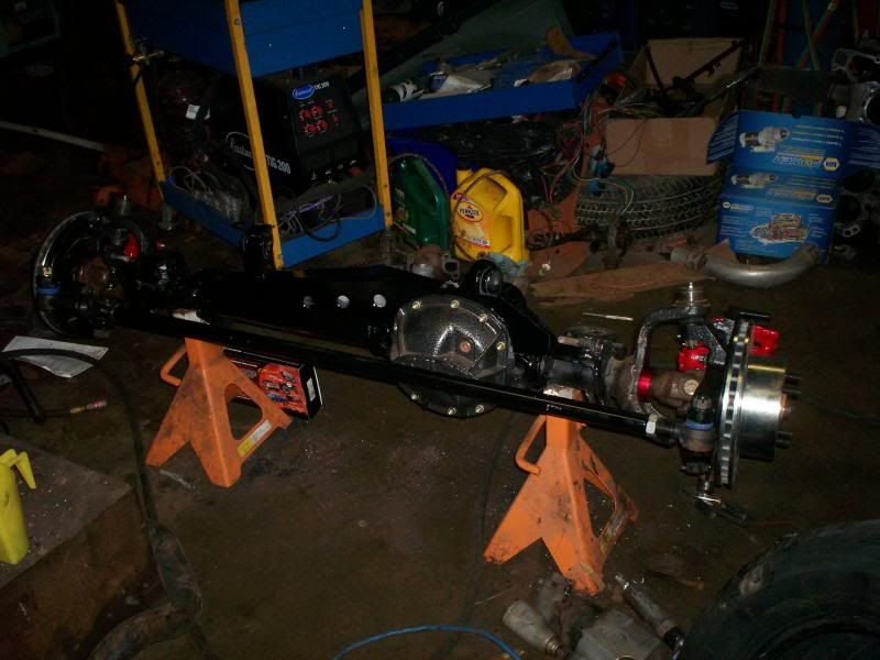

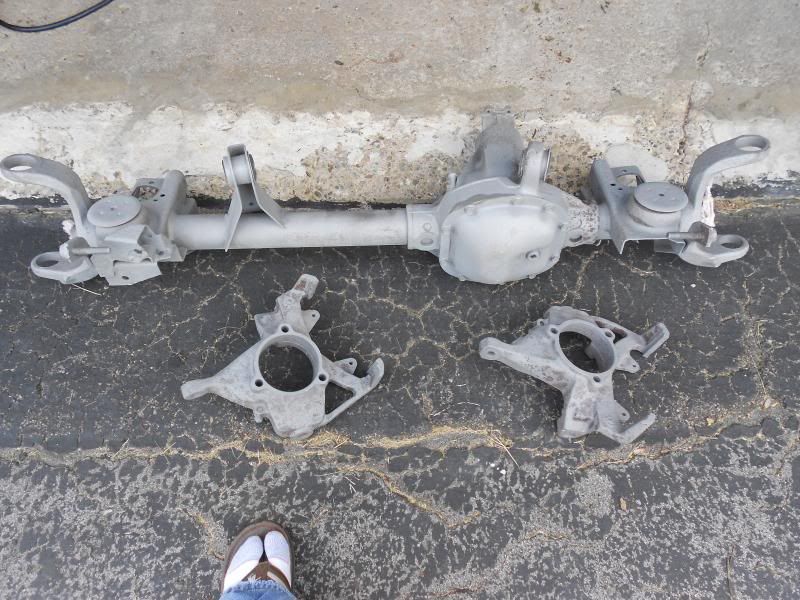

Prep, on the 8.25, I ground it down with a 4.5" grinding wheel, cut off the shock mounts to clean it down really good. I added JKS short shock mounts when I installed it. Primer, some rustolem primer (should have gotten some epoxy primer). First cost was Tractor implement paint from Tractor Supply. It's really tough & with stands a beating. Lightly sanded & used rattle can HighGloss rustolem. Did the same on my HP D30 except paid $75 to have that & both knuckles sand blasted. Should have done that to the 8.25 but well. HP D30 when I got it home: After sandblasting: Just before installing: That's off of a 96, 8.25 was off of a 98 My 8.25 w/ LSD was $100 from a friend highest I'd pay would be $150-$200 max. D30 was $125 off Craig's list & I've probably got about $2,500+ into both. HD steering, air lockers (Front/Rear) 4.56 gears, compressor, rear disk con., unit bearings, master installs, misc items, etc, etc. It ain't cheap, but will be reliable when I'm done. Reason for everything is to run 35's & wheel it with out too much worry. Good luck, ask tons of questions.
Sorry, brakes are amassing, recommend it 100%. The rear conversion went without a hitch, front brake rebuild, not as good. Jeep is parked till I get new (2nd) rotors. Live and learn.
