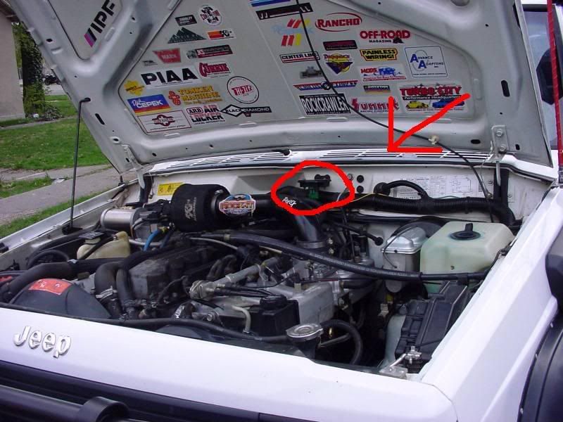

also on the firewall to the right of the valve cover theres a little black computer sensor(brain freeze cant think of what its called) but has ony 1 plug going in..make sure thats connected and tight..i had that problem before and that fixed it..if i find a pic of an enine bay ill mark it out for you

not my engine but this is what i was talking about

That's the MAP (Manifold Absolute Pressure) SENSOR. It senses intake manifold vacuum, and the ECU uses that, along with other inputs, to calculate F/A ratio, and adjust fuel injector pulse duration.
