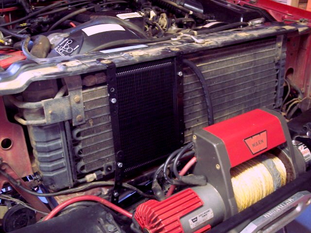

Very nice write up. I found this while looking for information on the subject for when I do my install at the end of May. I might also do a temp gauge just so I know what's going on - especially since now I know of one that fits the interior looks of my ZJ. However, did you ever put a resistor in there to make the bulb dimmer? I just did this in physics, maybe I could actually find the right size to make it look match....or I can be lazy and guess/check.

Really wish I had some black spray paint around when I did my install. Can't see the upper brackets, but the lower one sticks out pretty well. Catches my eye every time I look at the front of my XJ. Too much of a pain to take off and paint, but I guess I can do it whenever I get a new front bumper.

Originally Posted by jeepme95 View Post
How about your emgine temps, have they changed at all using that big of a cooler.
Yes. I had originally mounted it in front of the mechanical fan, but that blocked WAY too much air. It's now mid-grill, and while it does run hotter, it isn't excessive. It will, however, overheat if you idle with the A/C on for more than 15 min. I'm planning on dropping in a 3 row all metal unit soon.
I agree, my lower bracket is also a bit of an eyesore.

FWIW, I've got mine mounted directly in front of the mech fan and haven't seen any problems yet. The reason I mounted it there was because that section of the grille would always have constant airflow.
My engine runs slightly warmer than before, but still not really over 210*, and I attribute that to the fact that I bypassed the radiator, so it's no longer using the transmission fluid as a heat sink anymore.

Also, I guess it should be noted that I'm running a 3-core radiator.
