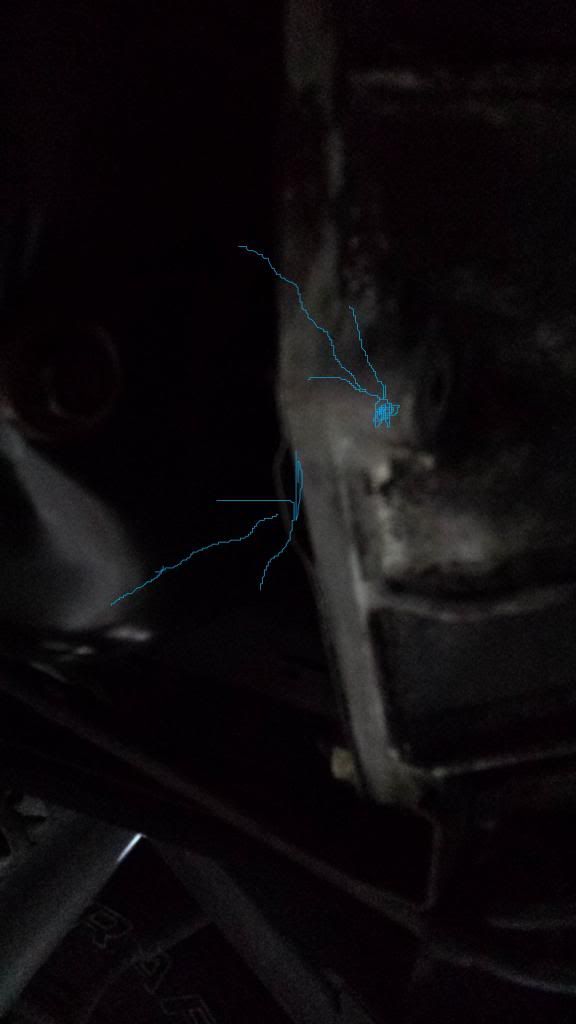

So was scoping things out today and noticed a very small amount of fluid on the ground...by small I mean maybe the size of a half dollar. In the picture below I put arrows to where the oil was dripping from. It was forming right under the hole that looks like a bolt would go in...but isn't this hole suppose to be there? Also I noticed it right around the little gap...not sure if this picture will do it any justice. Is this an easy fix? I planned on going ahead and replacing the gasket on the trans pan too...is this a gasket as well or something else and does this just seem like a gasket issue causing it to leak?

It's hard to tell with that pic, but I think we're looking at the front of the bell housing?
If so, that's a common place for oil to drip. Can you tell if it's engine or trans?
If it's engine, many folks will panic and tell you your RMS (Rear Main Seal) is gone. Well, maybe. Oil tends to run to that location and drip there, even from other places. It may be no big deal at all.

Here is another picture. White arrow is the engine oil drain plug. Yellow arrow is pointed right where I saw the small drip forming...also to the right....there is a small gap that you can see better in the other picture where a leak was forming as well.
You can see the gap in the picture

Are you are sure it's trans fluid? If it's trans fluid then it's most likely coming from the front input shaft seal. I had this problem back in November. Can be hard to tell if it's engine oil or trans fluid. I dropped the trans and replaced the $10 seal and now I'm just down to a RMS leak. I was also able to do all the other trans seals and u-joints while I was in there. My Cherokee (99) has 205k miles and the front transmission seal was toast. The other ones actully seemed pretty good, still pliable. The front one was brittle. I have already replaced the valve cover gasket and oil filter adapter o-rings. It leaks so little that I don't worry about it too much.

Judging from that it seems to be NOT leaking on to the oil pan...unless you had already wiped that clean and dry...I'd say it's NOT the RMS. Even so, if the PO said the RMS had been replaced, I'd take it with a grain of salt.
I would agree with this ^^^. Unfortunately the tranny will have to come out just to stick the seal in, a $10 part, behind the torque converter. Then if you're under there it might be prudent to replace the RMS anyway.
BTW the bolt hole at the bottom of the bell housing is just there to hold on the inspection plate/dust cover.
