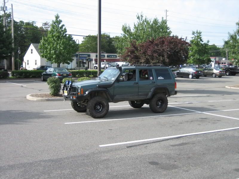

Alright, I've got a set of 31" Trxus on my truck now. Yeah, they're great, wearing a little fast, but they grip everything. I also have bushwackers and they just swallow these tires. I'm looking to upgrade to some 4.56's and either 33's or 35's. I trimmed my fenders as much as neatly possible and definitely have the room for 33's without a doubt. I have a RE 3.5" with full packs. It sits about 2 inches higher in the back, so I added my 1.5" spacer up front to level everything out. I was wondering if you guys think going right to 35's would be a good idea. I'm installing an Aussie up front soon and plan on an ARB in the rear in the future. I also don't beat the hell out of my truck when I'm wheeling it, it's my DD.
Here's what she looks like now.

If you are still interested in Trxus, they make a 34" as well. The BW will make anything smaller than a 33 look small.

id say go with the 33s no need to put that much more stress on it with 35s, that thing will look plenty nice with 33s under it. Looks very good right now, good job
