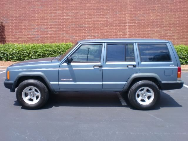

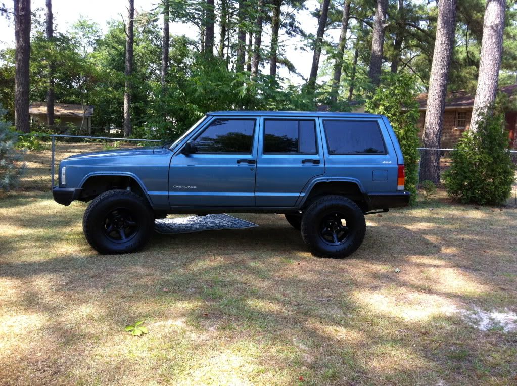

I lifted my jeep 3.5 lift with coil springs & 1.5 spacers in the front.
In the back I have a 2" add a leaf more like 1.5 tho, and 2" shekels.
I've been researching an SYE to eliminate the vibrations when the car is cruising and my foot is not on the gas pedal.
I just don't know how to install an SYE or all the parts that I need to buy.
here's some pics of before and after of the Jeep.
