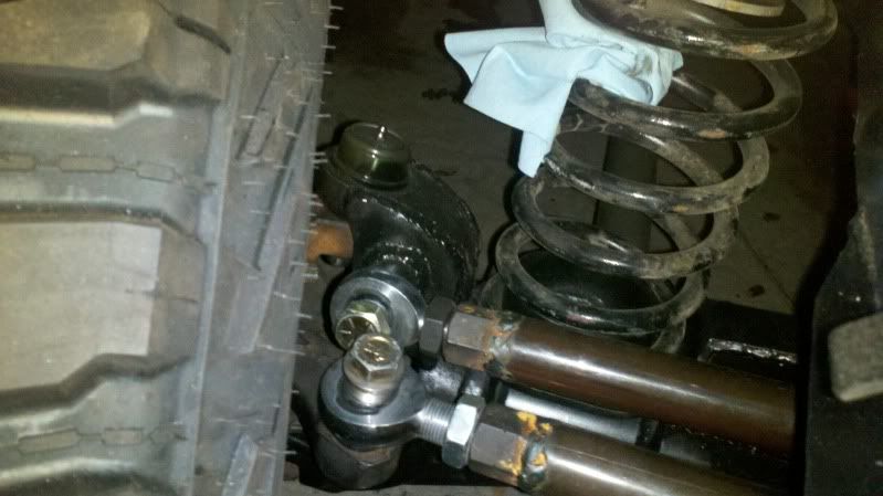

Ok, here is an update for anyone following this build. I've finally got my joints, jam nuts, and tube adapters for the Poly long arm brackets.
I also bit the bullet and ordered a couple other things I've been eyeing for a while now, since they have a 25% off sale going on right now. I've had my eye on T&M Metal Fabrication for a little while now, they seem to have some well thought out fixes for problem areas on XJs that nobody offers yet, I'm excited to see if the parts are as good as they look.
Door hinge brace(my passenger side seems to be fine, but I can see my drivers side is starting to become an issue)
The cracked B pillar vent on 2 doors(mines been an issue for a while, but doesn't look like it's gotten any worse since I noticed it)
http://www.t-mfab.com/store-3/
Not beautiful, but not bad since its been a few years since I've used a welder on a simi regular basis
Now, these are NOT plug and play pieces. Some bending, clamping, tacking, hammering, are needed to make these fit, as they are shipped flat. That being said, the installation was pretty straight forward, and if I had a fresh flap disk, or had taken the time to strip the paint out of the inside corners better, it would have went easier, as I wouldn't have been fighting getting decent contact and my welds would have looked better around the edges. Something to remember when I do the drivers side.

Black Magic brake pads $125 (Black Magic Brakes)
New WJ AKEBONO Calipers/brackets $130 (eBay)✔️
6-Hub bolts(WJ/JK) $40 (eBay) ✔️
4-Caliper bracket mounting bolts $18(Rock Auto) ✔️
RuffStuff 3/4" Heim Steering Kit *NO TUBE* $140 (RuffStuff) ✔️
RuffStuff 3/4" X 5/8" Heim Tie Rod Kit *NO TUBE*(for track bar) $60(Ruff Stuff) ✔️
3 X 5 ft- 1 1/2" OD x 1/4" wall x 1" ID DOM $150? (Local supplier)
1 ft- 1-1/4 OD x .250 wall x .750 ID DOM Track bar bracket(see below) $32 (The Metals Depot) ✔️
Not positive what I'm going to do(if I even need to) for sway bar link brackets, need to look and see what others had to do, or figure it out once I start putting parts on.
As for the track bar mount:
Blaine Johnson can be credited for this design, as found on the Team NAXJA KOH rig.
I know there are several people wondering why I spent so much on new steering knuckles instead of getting them from the junkyard. For me the answer was easy. The junkyard here wants $60 each, and I would have to go pull them. Then because I'm OCD, I have to sand blast and paint them. For the amount of time it would take me to go get them and clean them up, it was worth it to me to spend the extra bit to just get new ones.
