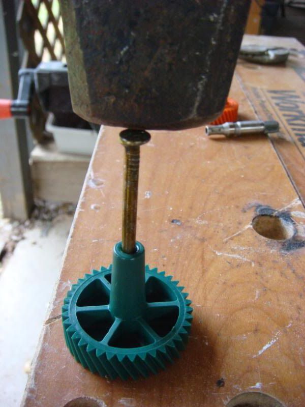

Anyway back to switching the shafts. First you take a torch and heat the shaft of your old gear, until you see the plastic start to bubble around where the shaft enters. Flip the gear over and use a punch or nail to tap the shaft out. (Take note to how far in the shaft goes in so you can get the correct length) Repeat this process for the new gear to get the shaft out of it.

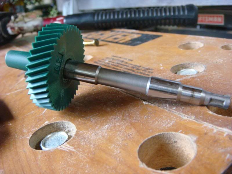

New gear, with the short shaft

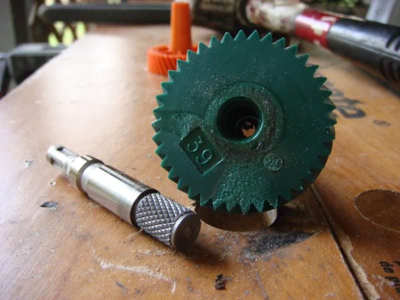

Now heat the end of the long shaft that you are putting in the new gear, until the end turns purple/blue. Now slide the shaft into the gear and make sure it goes in strait.
Here is the gear finished
