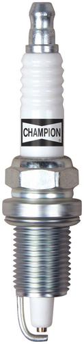

I picked up a set of 6 Champion 4412 truck plugs for ~$8.00.
4412
412

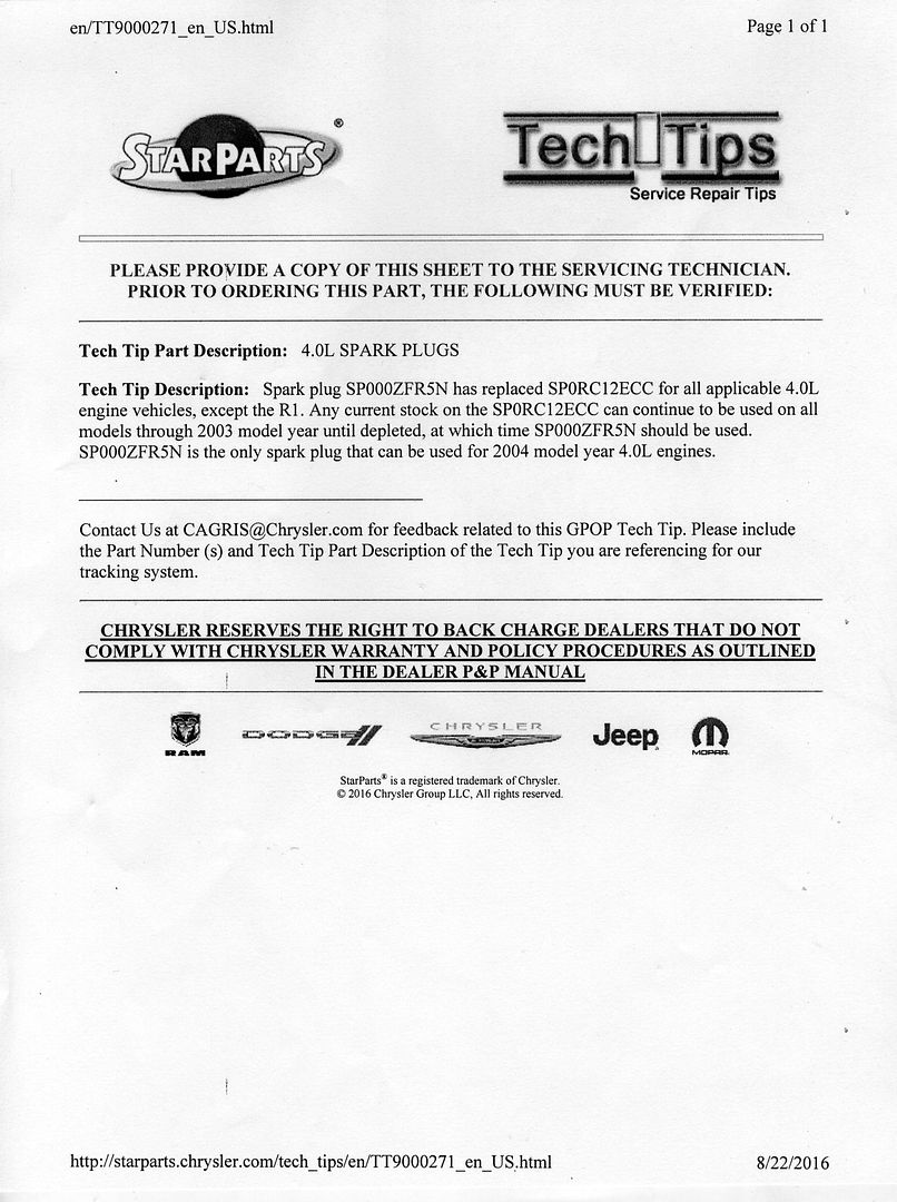

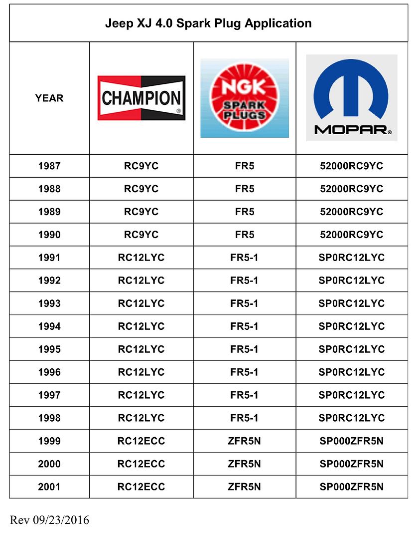

Here's a spark plug application chart and Chrysler tech tip.
For a 1998 4.0 I would suggest the NGK ZFR5N plugs even though the chart says differently.
CCKen is offline
Why do you prefer the NGK over the Champion? What's the difference between the two plugs, NGK ZFR5N and Champion RC12LYC?
