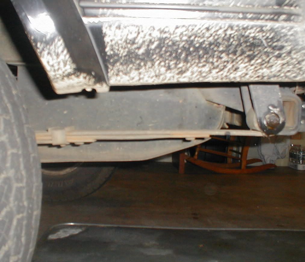

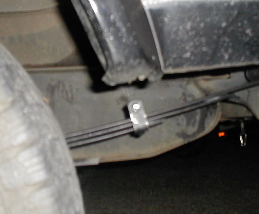

This is what a 3.5 spring pack looks like on my XJ, with MJ shackles. Note the arch...and added strength
This is what a stock spring pack looks like with extended shackles. Note the lack of any arch and the flat spring. This spring is under added stress and has less ability to flex, or support any additional weight. Really, just an illustration of how hard extended shackles are on an XJ's stock spring pack. Before I installed these shackles the spring had a slight upward arch. This is with stock springs on a 1990 XJ with 220K on the springs.
I'm not trying to dis your Jeep, but you did ask for input, so here's mine.
Thanks. I'm not offended. I just thought maybe I could get some life out of these for a while. Guess I'll just order some OME's.
