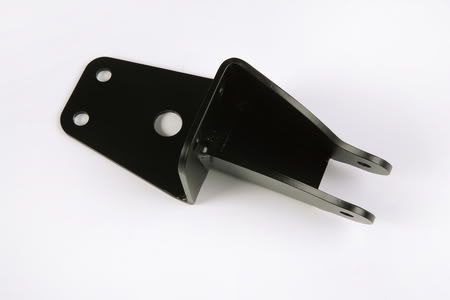

I see yeah that does make a lot more sense. Does that mount into some existing holes or will I have to re-drill to install that? I think I'll order it tonight, provided they ship out here to HI.
Mounts in the existing holes. I suggest tack welding the bracket in place, though. I struggled for months with my stock bracket and this bracket to keep the bolts tight enough to not make noise. I broke several 1/2" Grade 8 bolts trying to get it tight enough to not squeak or pop. Finally I just had a friend weld the bracket to the frame (three 1" stitch welds) and two years later it's still not made a peep.

Shipping to Oahu on the TNT bracket is as much as the actual bracket ($100), so I started shopping around to see some more options.
This is the IRO drop bracket pictured above --
IRON ROCK OFF ROAD: XJ/ZJ Track Bar Drop Bracket
$100 to my door - a little better! Anyone used this or know why it's awesome and/or sucks?

I have had the IRO double shear for about a year and it's seen about 15,000 miles i have never had an issue with bolts coming loose or anything. The only complaint was the lower bolt work but was a tad short for my liking so i used a longer grade 8 bolt and again no issues.

I see - so worth it for ya? I'm considering the full double sheer or just the trac-bar drop mount.
For me, the double sheer was worth the cost. I do not know of anyone that makes and sells a drop bracket that will use a single sheer (OE mount style) track bar.

so the TNT and the IRO (above) ones are both just for double shear?
