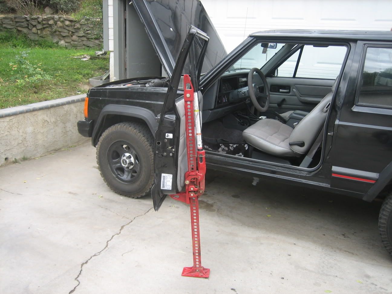

After driving in it on the freeway, I couldn't help but notice the excessive wind noise from the door. I looked into it and found the upper door hinge was breaking away from the body, causing the door to sag and seperate from the jamb. So I got my nifty High Lift Jack off of my TJ and used it to my advantage
After that, I busted out the welder and welded the hinge. It's got to be the UGLIEST weld I've ever seen in my life, but it works. And FWIW, gassles flux core welding sucks . But the hinge is fixed, and I sprayed it with some paint to prevent rusting.

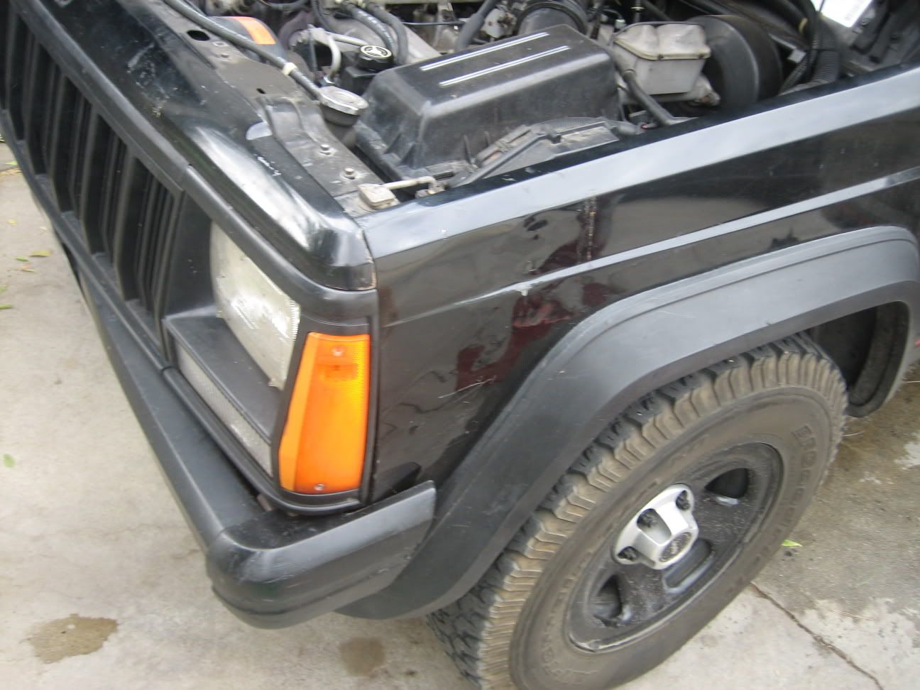

Now, It was time for me to start body work. I was able to pop out most of the dent behind the door. Got a 2x4, took apart the trim inside and banged it out. It's still a little warped, but i'll clean it up with body filler. I also took the fender off and banged that out a little too
Before
After

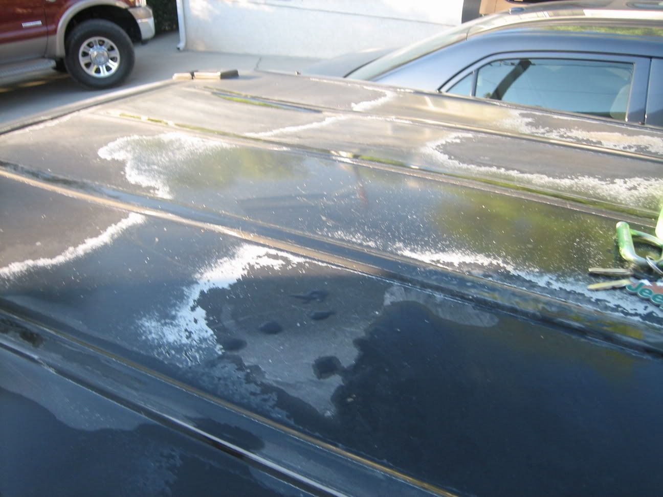

I took off the roof rack then gave it a quick wash with water, and then wiped the whole roof down with acetone. The paint on most of the body is Ok...but the top had clear coat peeling off.
Let me tell you, hand sanding is a *****. I did about half of the roof, and my dad finally tells me "I have a power sander you can use!" Thanks pops...

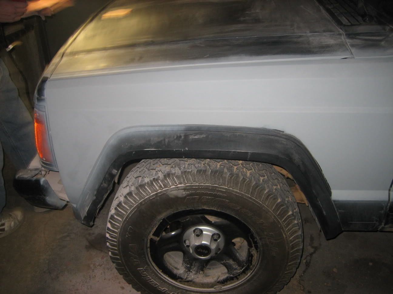

Update. Not much has changed, but I got the whole front end done. We're working on getting a new front bumper now. Looking at the Warrior products bumper. It's nothing fancy, but it's cheap, and doesn't look bad.
First off, here's the headliner. I'm not a fan of the fabric she picked, but what she says goes. I still have yet to do the sound bar. I ran out of glue...

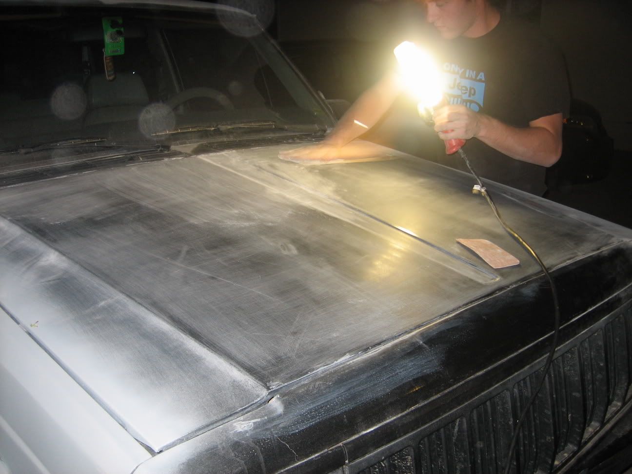

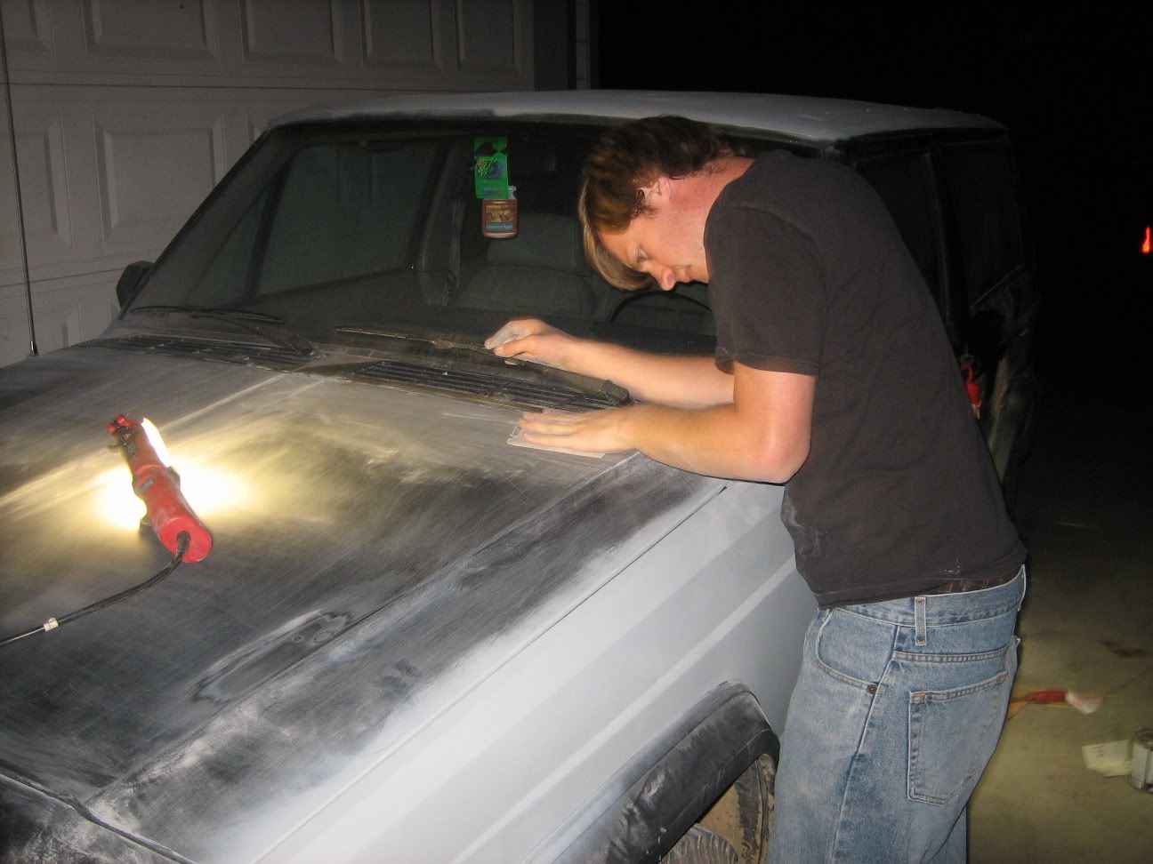

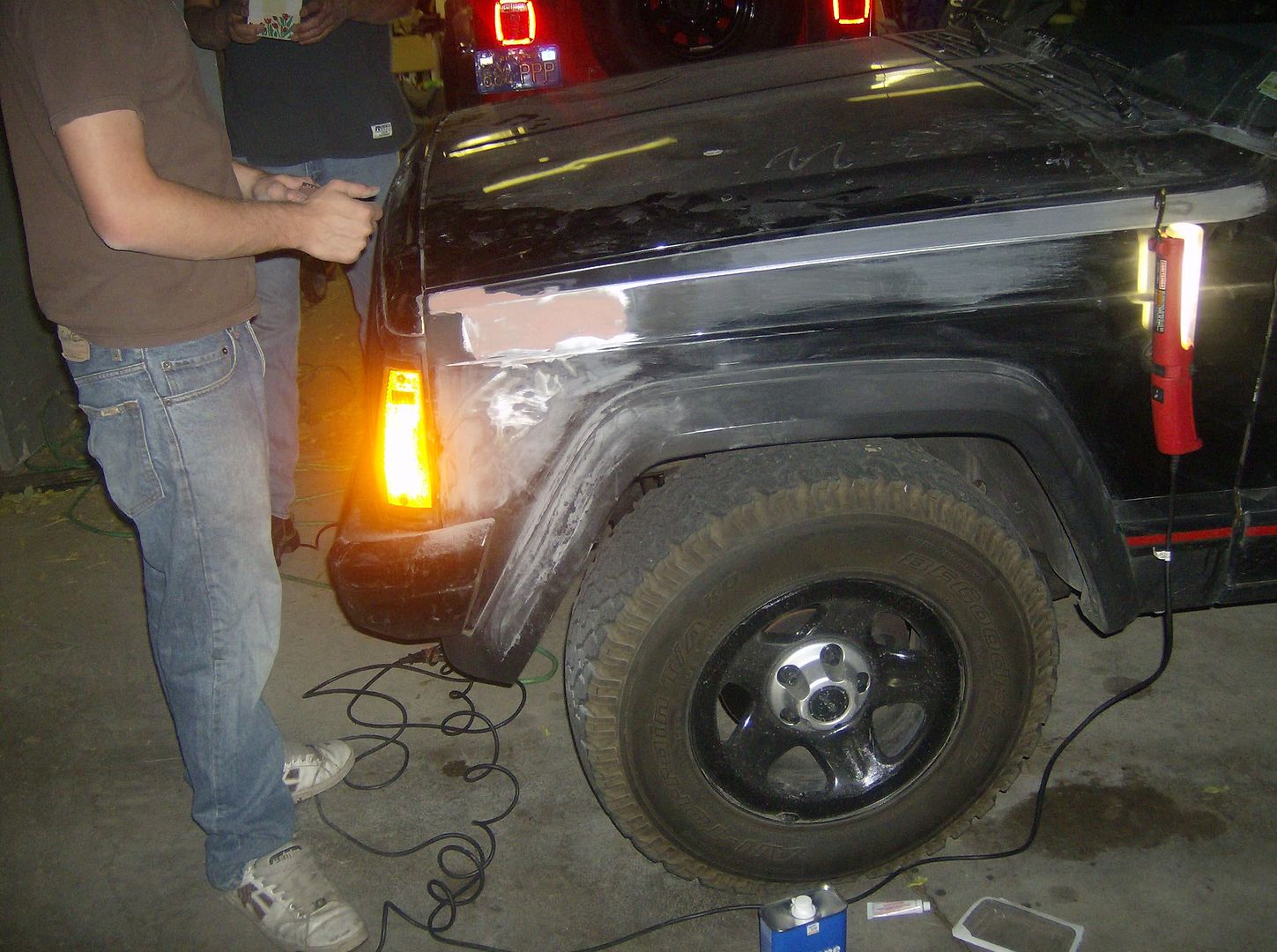

Here's pic's of the front end. The hood is good (with the exception of one little ding) so I just sanded it down and put the primer down. I know, A LOT of overspray. But it shouldn't be hard to remove with acetone.
Sorry for the night pics, but I was working a lot today and didn't get that many shots. Most of the work went into that crappy fender. It's done too, but I have to pull the flares off so I can sand the whole thing.

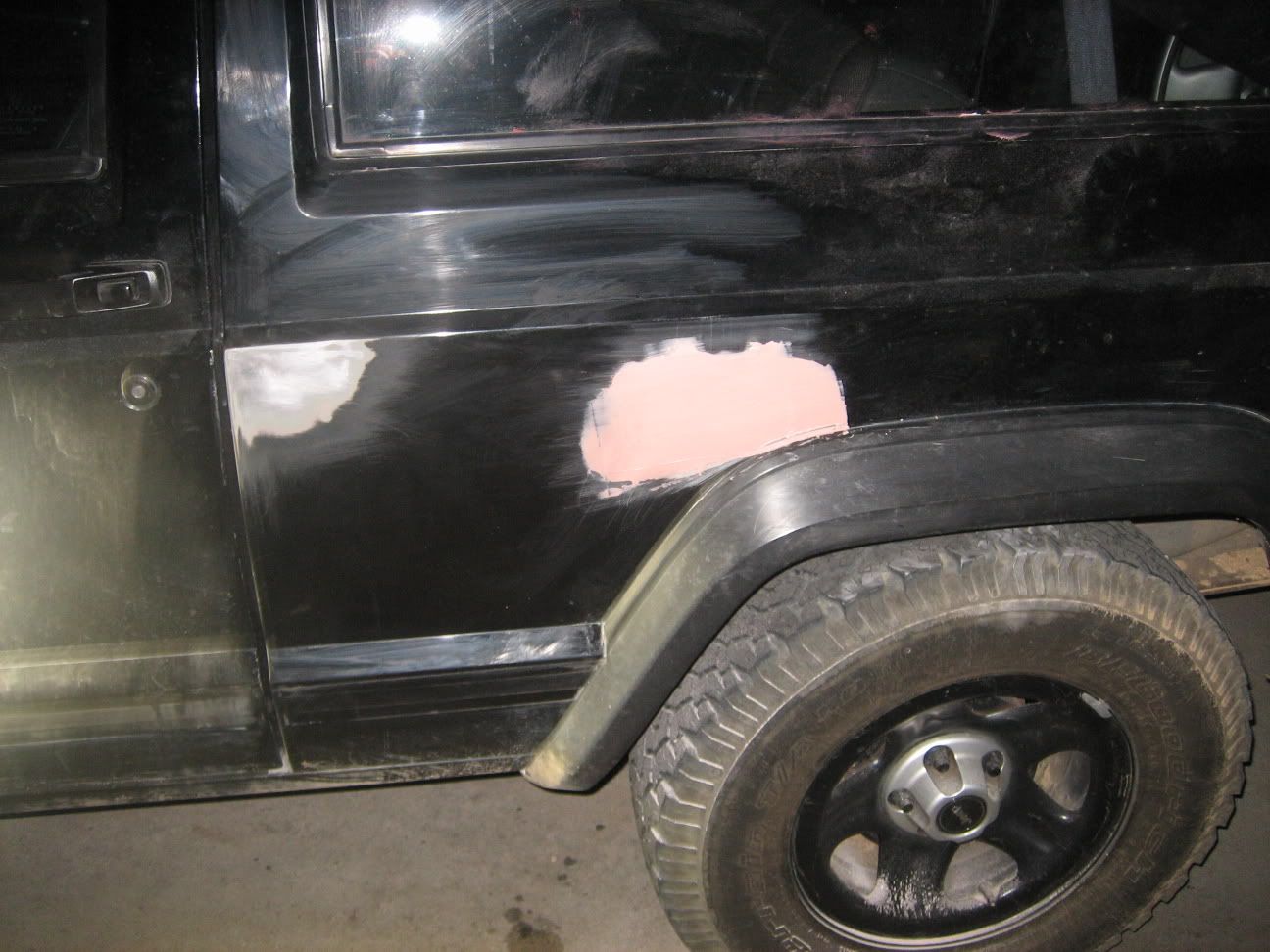

And then here's right behind the drivers door. Yes, that is a lot of bondo. And it's only a little door ding. I just got bored and decided to slap a whole bunch on there. More work, but oh well...
