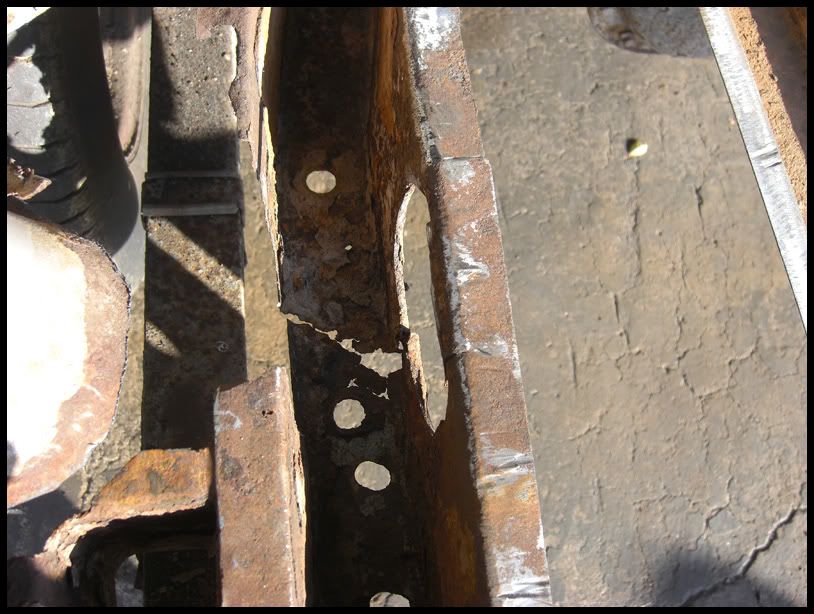

So small update, did a bunch more cutting today, and a little wire wheelings, got a late start, I feel like crap.
picture of the rail where its broke. I'm platting from well infront of the break all the way to the back of the jeep with 3/16th on all 4 sides. I also plated from shackle mount to shackle mount all the way across the back of the jeep. It will be way stronger / better than stock, not to mention my bumper mount inside of all that.

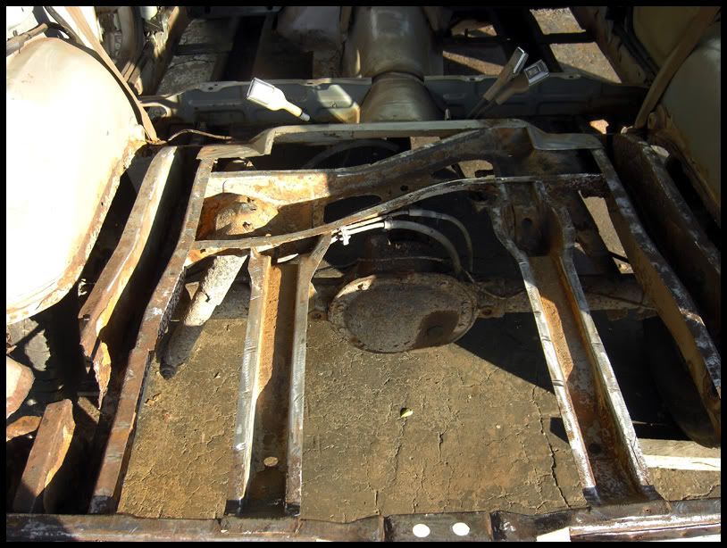

all the stuff in the rear inside the channels is all cleaned up and now in a coat of rusty metal primer, a nice coat.
i still have about a foot of mail rail inbetween where i did in the front and back to do, but theres still more cleaning and cutting to do in that area.
I know in the areas on the rail where i weld plates to reenforce it, will have paint bubbling off, but i plan to replace that paint when it does.

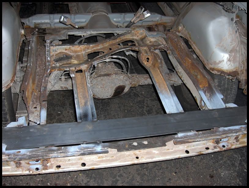

no pics, weather has been terrible, doing what I can.
the plate across the rear has been tied in up into the body, also like 18'' of the bottom of both u channels all the way to the back, has been re-enforced with plate and all welded in.
Plus across the back of the long plate has a bunch of welding to fill some small gaps. Its going to be ridiculous strong. I'll get some more pics soon hopefully.

Another panel is now cut and tached in, along with a panel for infront of it. Trying to make due with what I have in 14 guage steel, so i dont have to go cutting big chunks, and i dont want to use 18 gauge in the rear, because i haul parts ALOT.
i didnt prime anything because its below 40, and it gets colder overnight, ill be down there in the morning working again and dont want to be in wet primer.
