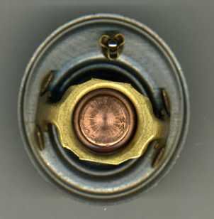

He shouldn't have to burp his open system (2000 XJ 4.0), provided he used a T-Stat with a bleed valve/hole/V-notch in his T-Start. OEM Stats are the best. See pics.
Yes, that's the one I got. Thank you all.
