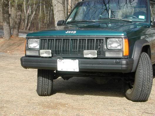

Here ya go. Its pretty self explanatory. There are 5 bolts along the top, and one to each fender. You'll have to trim the very bottom of each fender flare to make it look right.

This is an easy thing to do and it looks nice, here is a link that tells you how. You basically just unbolt it and then trim the flares to make it look nice.
http://jeepin.com/features/stageone/index.asp
This is the only pic. I could find of mine that shows a little of the trim, and removed dam.
