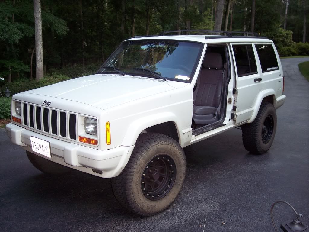

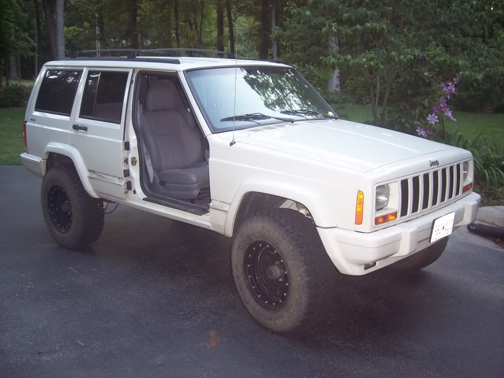

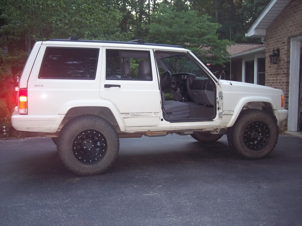

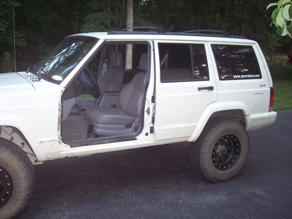

Yeehah, just pulled my doors off this evening. Not fun in the 90+ degree heat and humidity, I think I lost 5-10 lbs worth of sweat. Definitely wasn't a bad task, took less than 2 hours for the whole thing, mainly because I kept breaking the little crappy cutting wheels on my dremel. I think I used almost half of a 36 pack... I bought 5/16" grade 8 bolts and nuts to put them back on and everything fit just fine. The doors sag about 1/4-1/2" when opened on the bolts, but go right into place when I close them. Only problem I had was dealing with the damn electrical plugs and grommets. The passenger side plugs are super hard to get to being jammed up around the fuse panel, plus I can't stand fitting the rubber grommets back in the holes. I drove around a bit and love it, although it will take some getting used to. Might try to find someone to make me some basic tube doors. Anyways, here are pics! Oh yeah, ripped off the side trim on the doors so I can get ready to pull the flares, trim the fenders and herculine.

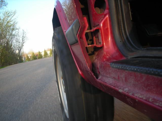

it did start to rain one time when i had the doors off..i only drove a mile in the rain. nothing got inside the jeep. wasnt coming down hard enough. it did get on the rear pillar a little bit but that was only when driving, it was only sprinkling though.

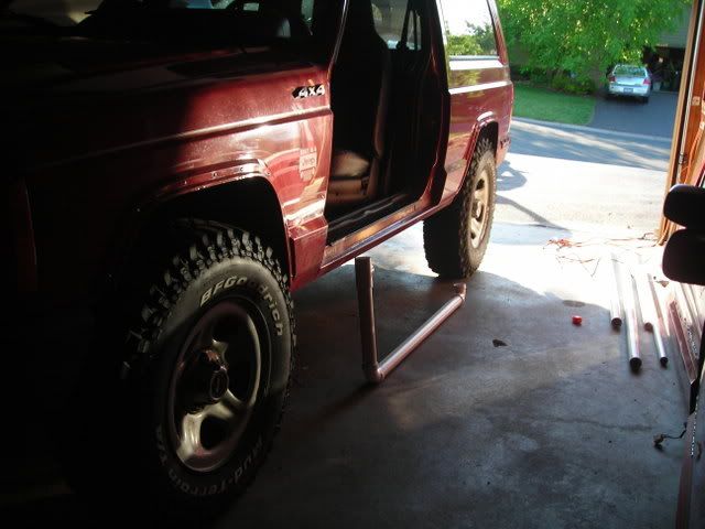

as for ways to make taking the doors off 20x easier..ive already started
