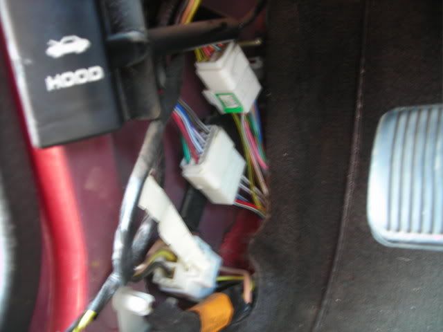

just for reference on the electrical part..heres a picture of the connectors on the drivers side kick panel
i bought some 1/4x20 bolts but it sags like a *****. tonight i picked up some 5/16 bolts (grade 8) so hopefully it wont sag as much. i plan on making some soft doors for mine because being doorless is just awesome, but bad weather isnt. and i dont want to be at work and be totally screwed so i plan on making some light weight doors that i can just toss in the back.
