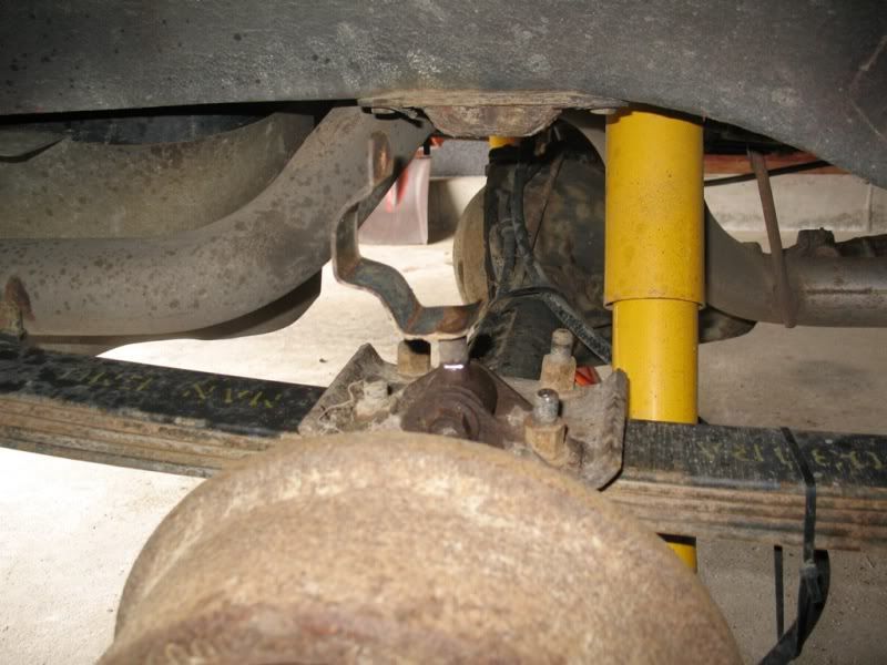

Posts: 1,776
I was able to remove the sway bar, but it left behind this bracket. So, I cut it on the shiny line you see with a 3.5" rotary cutoff wheel. You could do it with a hacksaw or a sawz-all but this was the easiest way for me.
