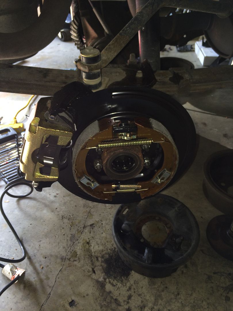

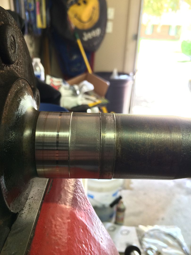

Im putting rear disks on my brother 99xj. It has 155k on it and when I went to pull the drivers side axle shaft it wouldnt come out. I wiggled it around and it popped out when I noticed the bearing has worn a small groove around the axle. How big of a deal is this? Should I go ahead and get a new axle shaft? The bearing looks and feels great but should I replace it while I'm in there? Ill post a pic in a bit.
Also, Ive got the disks on but Im undecided as to what to do for the hard brake lines. Ive read several write ups and no one ever talks about what to do with the hard brake lines. The flex line screws onto the hard line to problem but do I just bend the hard line? The instructions say to buy new hard line and bend it but I sure hate to do that. The kit came with a clip to weld to the axle to mount the flex line to but I dont have a welder. Cant use a screw clamp either since the clip is oriented side ways.

Well Ive decided to go ahead and get a stock replacement axle shaft. The groove is just too deep. Is the napa axle replacement a good axle? There is no reason to upgrade these axles, I just want a good stock replacement. Looks like the axle from napa comes with the seal and bearing but idk if they are of good quality. Anyone know if the BRG R1559TV bearing and NOS 16805 seal are any good? They are $22.50 and $16.50 on the website.

NAPA parts are acceptable. Axles, bearings, and seals are pretty simple to get right.
Any roughness, pitting, or grooving of a bearing surface makes repair/replacement required.

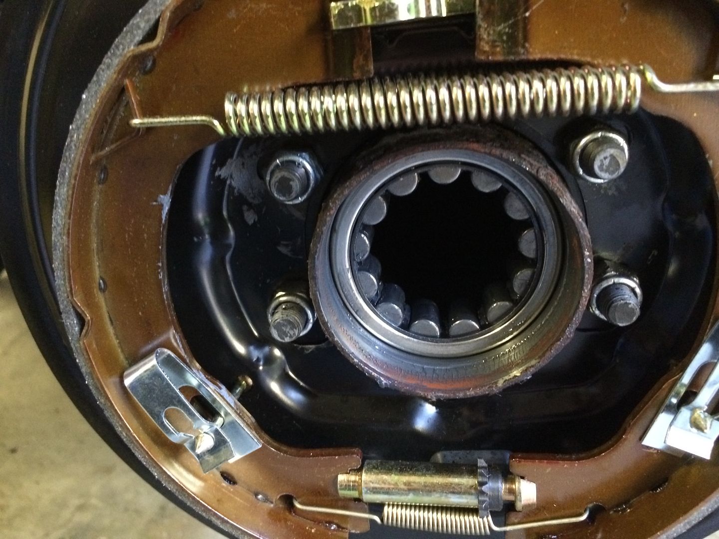

Got the bearing out and installed this evening. It was very quick and easy once I had everything together. The timken bearing from autozone has USA on it, so I assume its made in USA. They tried to sell me an all in one unit at first with the seal and such in one piece but I didnt like it. It had a seal on each side of the bearing so the gear oil never got to the bearing, horrible idea I think. it had some grease smeared around in it but its a dumb idea I think.

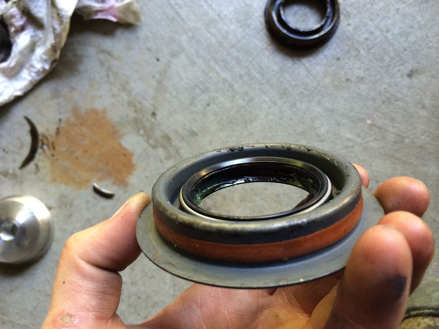

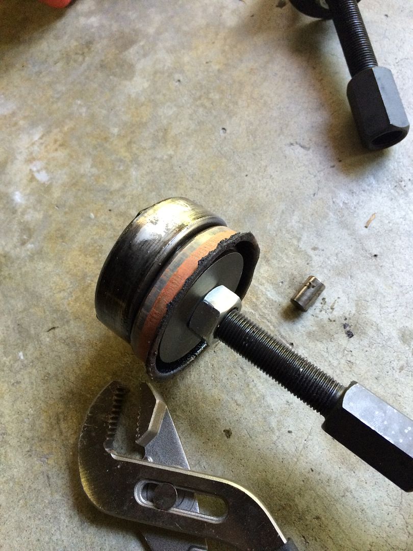

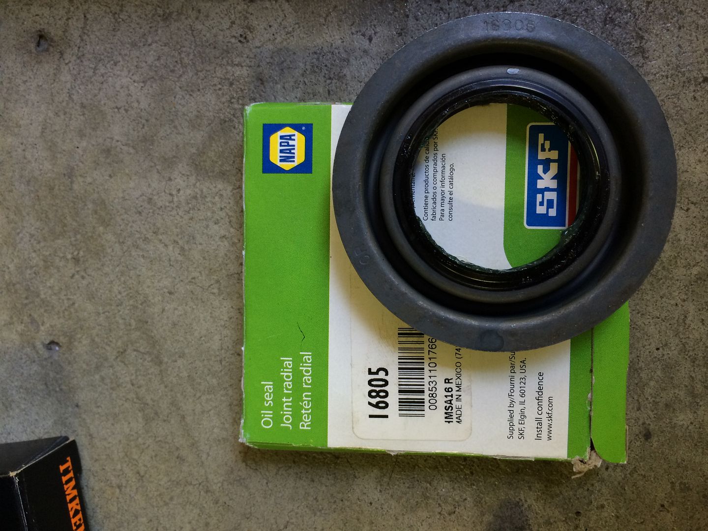

The seal that napa gave me is the wrong seal. It shows its for a 8.25 but its way too big. I slid it over the axle to try it and it had a gap around it, pitiful. Once I got the stock unit unit out I realized its like a double seal. I picked up a timken from autozone and its just a single seal, so Im back to square one on the seal. May call the dealer and see what they have and how much it is. Ill post up pics as soon as they load up. May do a quick write up on the disk conversion and bearing replacement once I'm done. I've read several write ups and there is always something I have a question about.

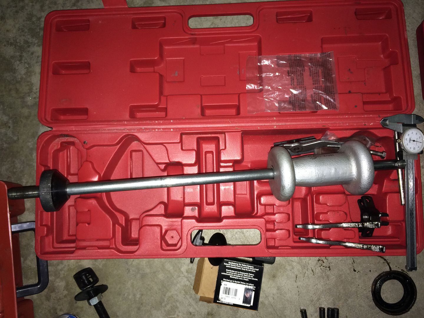

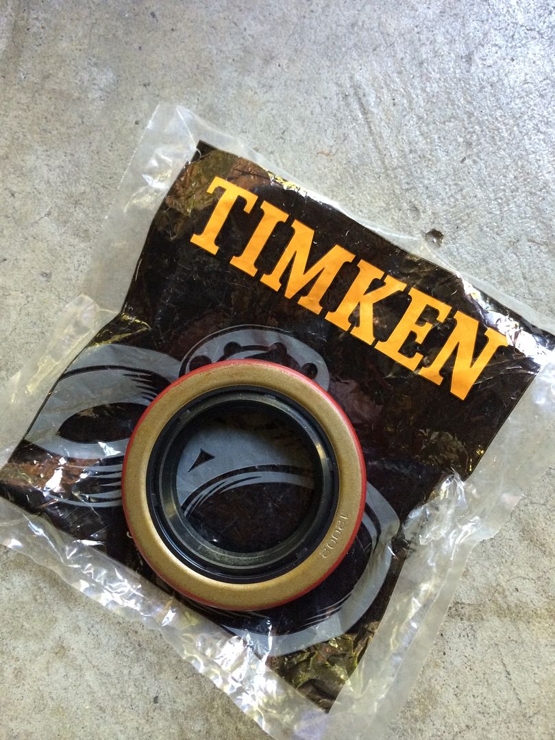

The 3 jaw puller ended up being useless for me. The one I rented was had well rounded off ears so I had to go back and get the other type of axle bearing puller. It worked very well once I used the correct size puller. The first one just pulled the bearings out.
Stock seal vs napa seal. Napa seal was too big in all categories.
Double lip napa:
Single lip timken from autozone:
Also, I used the bearing hammer thing from autozone. Worked fantastic but Im sure a socket would work the same. Ive got around $200 in tools rented right now. As it sits now, waiting on the correct seal. When you hammer the bearing in, you will easily be able to tell when it bottoms out.

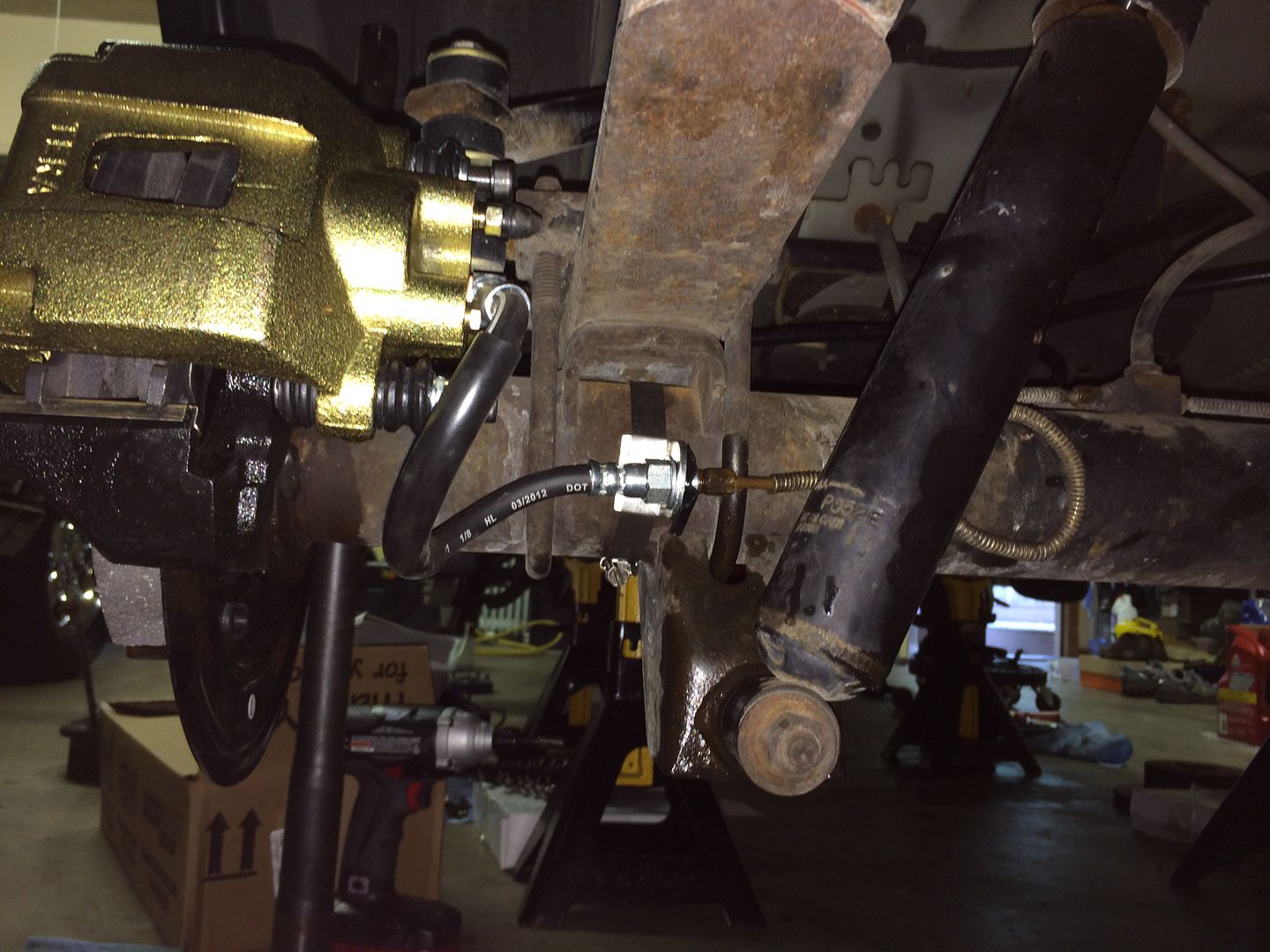

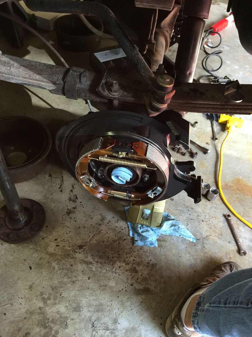

Some pics of the brakes with the stock lines all bent up. I should just get some brake lines from the parts store and bend them, but if this doesnt leak Im ok with it.
What kind of clamp are you using to hold the fitting against the axle housing where the flexible hose attaches to the hard line?

Just a typical band clamp i had laying around. Thing was a foot long or so, zipped it down and cut the slack off. Bracket came with the disk brake kit from terra.
