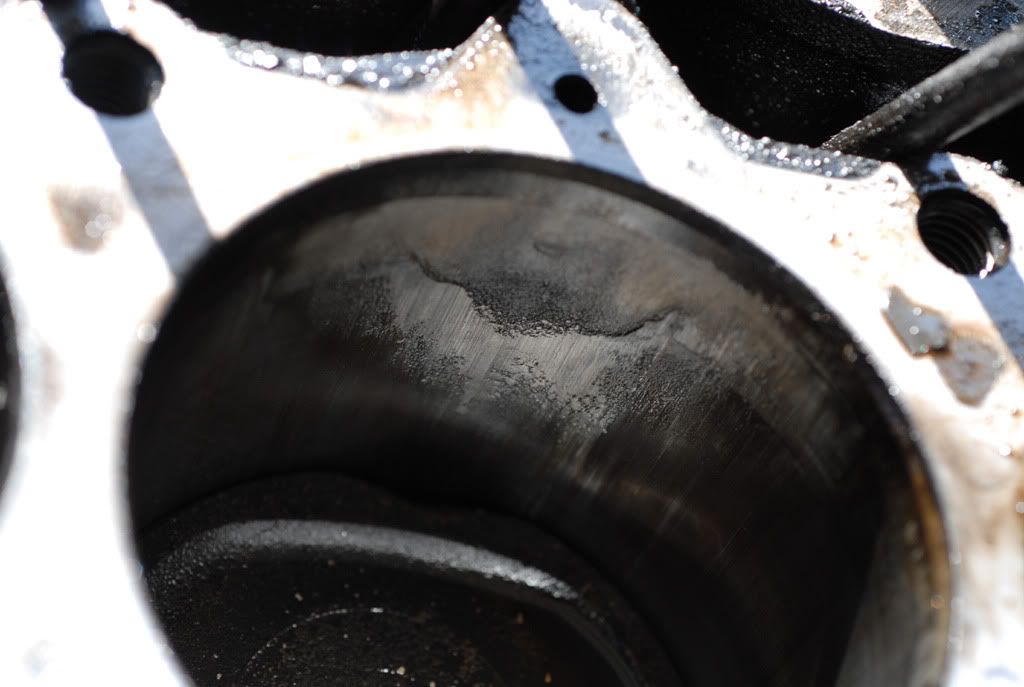

BTW,.. here is a picture of Cyl# 3 on my jeep,.. This is badly scored, and you can see the piston is damaged,..

Originally Posted by Wiskey View Post
Ummm,.. something's wrong. The cylinders should be within 10-15% of each other,.. so either the gasket is not seated right on cylinder 3, or the head is cracked/warped,.. or the block is damaged like my cylinder #3 was. Was there any visible scoring on the cylinder wall? Was there any damage to the piston? Did the valves seat properly? Did you give it a chance to pump the valve lifters up, did you give them a chance to bleed down? Was the compression gauge in securely? What is the history on this head?
Try it again tomorrow without the oil,.. then try your oil idea and report back,.. if the compression goes way up with the oil then we know it's low for a ring related issue,.. if it stays the same we know it's top end some where (Valve, head gasket, head)
Sorry it didn't come out perfect first try,.. but I'm sure you can get it worked out
Whiskey
The head is brand new and came with the valves already seated. I didn't see any scoring on the cylinder wall, but that doesn't mean there wasn't any. The compression gauge was in pretty snug, and I did the test a couple times to be sure of that.
On the dry test, cylinder three compressed to about 100 psi, so a little better than the 90 before. After I added the oil, the compression shot up over 300 psi... I don't have time tonight, but I'll be taking the head off and taking a look at that cylinder. Is it safe to assume that the piston will need to be removed? From what I understand, the culprit is probably the rings, a damaged cylinder wall, or damaged piston. I'm guess rings since I didn't see any damage before I replaced the head. Thanks for all your help through this!!
