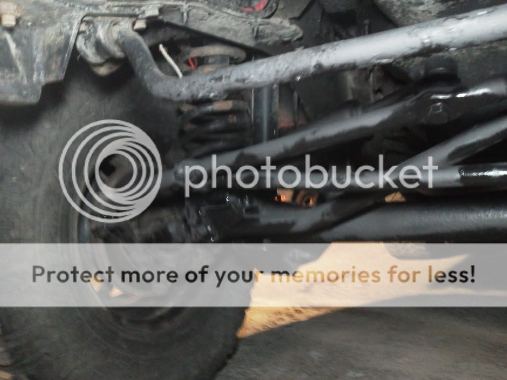

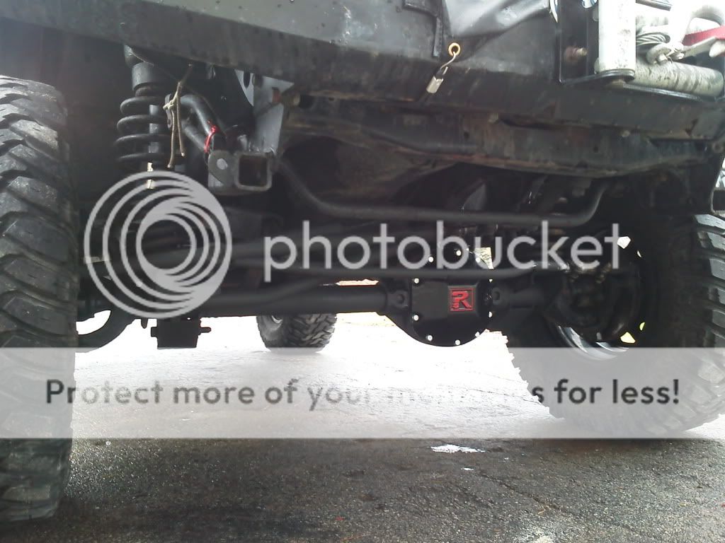

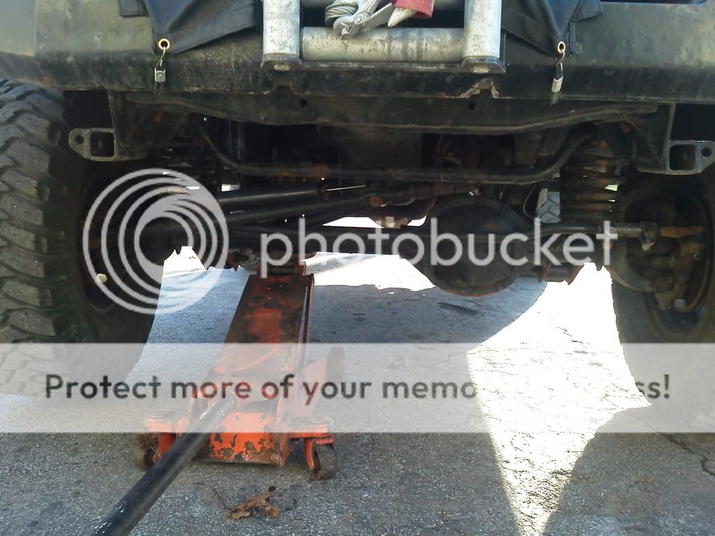

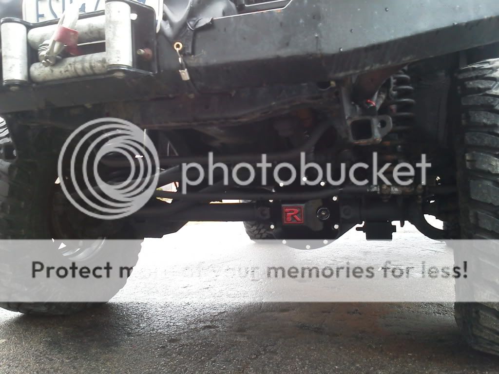

Image with just the drivers side flipped.
And let me say, holy **** does she drive better. The steering wheel is so much easier to turn especially when parking. Tried some high speed pot holes but no bumpsteer, I guess I do have a new stabilizer but none the less. The drag link was super hard to find in the JY, been waiting for a good one for a long time. Any Q's let me know

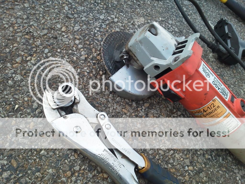

Drilled out and replaced with a conical insert? What drag link did you use?
Goferit insert welded in, RHD cherokee drag link.
Did you weld all the way around the lip?
Yep, then packed sand for a slow cooldown time

Can you explain what you've done here, what parts you used, etc?
Go Fer It Offroad TRE flip inserts. You drill the knuckle then weld this insert in, which allows you to bolt your TRE in through the top instead of the bottom.
Then, he used the drag link from a RHD XJ since the bend is in the opposite direction. That means you can flip it over and the bend is the correct direction for a LHD XJ and the link is upside down. This moves both mount points above the knuckle instead of below. This provides dramatically better handling and clearance for the steering. It also provides 100% win
