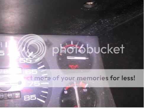

So I notice this when I got to work this morning. Oil pressure has always been between 40 and 60. Maybe a little higher under hard acceleration. I do know I need an oil change, but it has only been about 5000 miles. I am usually really good about doing one about every 3000-4000 miles. Anyways, I'm thinking this might just be a faulty guage. When I turn the engine off, all the other guages zero out. The oil guage stays just like this.
Any Ideas?
Thanks in advance,
-X

Check your fluid levels.... then disconnect the wire at the sending unit, you either have a bad sending unit, or you have a short in the wire causing it to ground out, which will peg your guage out.

Will check fluids at lunchtime. But I do know that contrary to normal XJ functioning, mine loses ZERO oil between oil changes, No spots on the driveway.
I just found it strange the the needle remained pegged after the engine was shut off.

That's a bad sending unit!
easy to fix!
easy to fix!
Thanks Jeff...
Did a little more research and found others with the same symptom which was resolved with a new sending unit.

Beware, a lot of people, myself included, often have OPSUs that are bad out of the box, so if it doesn't work don't forget it could still be the sending unit.
I did notice quite a few others having this problem. Is this a quality control issue? I don't understand why so many new units would be faulty from the manufacturer.
