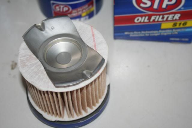

Just took apart a OE Mopar oil filter (was used on a 3.7 Jeep motor) and the bypass spring from it required 20 lbs to fully compress it. It took only 7 lbs to fully compress the Fram bypass spring.
