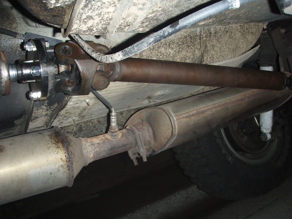

Can someone please post a pic of the Spicer adapter with front XJ driveshaft being used with a RE hack n tap SYE!!!!

So, looks like you have to take the front half of the CV off and swap them out. I already have that piece that must come with the RE shaft. Now I know what to do for a spare!!! That way I only need to carry 1 shaft and use it for either end in case of failure etc.
