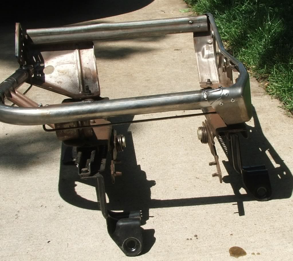

Concerning the broken seat, here area few pics showing damge and repair.
My seat may have been worse than yours but the only way to find out is to remove the seat from the vehicle and pull the covers off and examine the structure.
My seat structure was pretty well cracked and twisted. I had to twist the framework back into position and hold it in place with vicegrips while I drilled and pop riveted it back into place. I had a friend weld up the cracks (no photos of the welds).

Wow your seat is different, I should go out and take pictures of my seat. Basically where you welded and riveted that bar, I have an angle iron with multiple holes. While I can't see up under the backing of the chair, I imagine I'll find a number of rusted, bent and broken bolts with bent or broken washers. Once I figure out how to get the jeep started. I'm going to go and park it in the Canadian Tire underground garage and figure this out..
