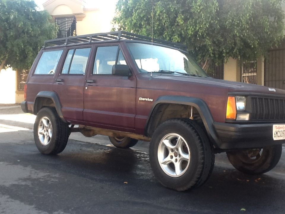

Thank you guys for your suggestions! I will give it a bit more thought as gearing might be an issue for me. Anyways, another question for the jeep experts here. How much lift would you guys say this jeep has? I bought is as it is. Maybe you can have a clue by comparing the 16 inch wheel to the rocker?

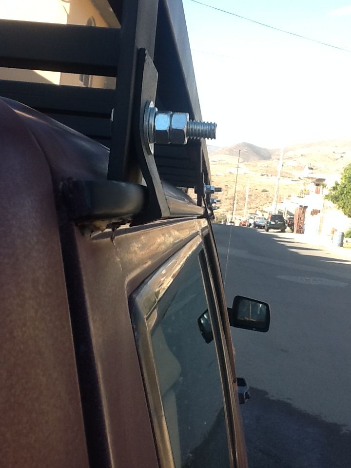

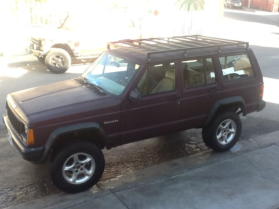

This is my new roof rack. I wanted a FULL size rack but for it to be low profile and strong. This was my best idea. I went squared to try to match the xj. What do you guys think?

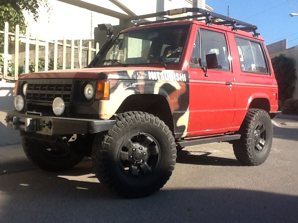

Oh and this is MY toy.

post #19 of 32 Old 08-28-2013, 07:23 PM
ECL
Join Date: Dec 2005
Location: Easton
Posts: 500
Nothing to add on the rear issue but I like the rack. Suggestion -turn the bolts around so the nuts are inboard. Some day when you're loading something on the roof, you'll appreciate not ripping your shirt or your skin on those exposed threads.
I will flip the bolts and i will get shorter ones. i only had those available and i thought they were too long and would hit the roof if the other way around. Thanks buddy. I plan on maybe adding unistrut rails on the sides to add some tie down points that can slide back and forth.

post #26 of 32 Old 08-30-2013, 08:54 AM
raypla
Location: Troy
Posts: 383
The way too measure your height is measure from the center of the wheel to the bottom of the flare, stock f- 17.5" r-17, I think. Whatever over those measures is your lift.
Where did you get that roof rack?
Thanks buddy! I will measure tomorrow!

post #30 of 32 Old 09-01-2013, 08:36 AM
Azzy
Location: Finleyville
Posts: 3,334
Im running 5x5 "adapters" on mine. With proper tightening and care, its the same as different backspacing. I would just make sure to keep hub-centric if your vehicle is, for the extra piece of mind.
I like the idea of a new hub being made... but it may cost you. As for how much lift... whats the distance from your center to the bottom of the stock flaring? IIRC, stock is 17" up front.
