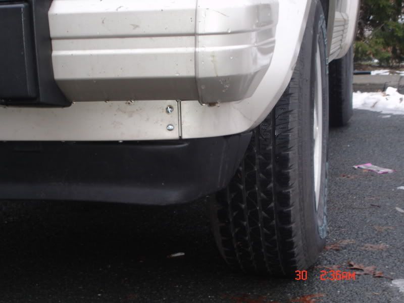

Was browsing the internet and came across this.
http://www.naxja.org/forum/showthread.php?t=941439
A air dam from a blazer or jimmy is the right size for 96 and under at least (not sure about the later ones with the different bumper) and with some tweaks it'd blend right in I bet.
Extending the air dam has been something I've been wanting to do and this seems pretty easy provided you can find one.
