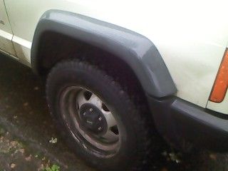

What's the best product for making these fender flares black again? Thanks...
