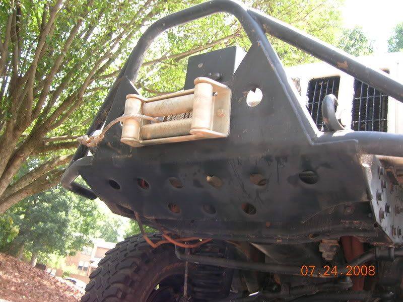

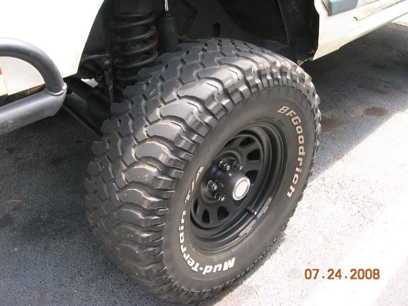

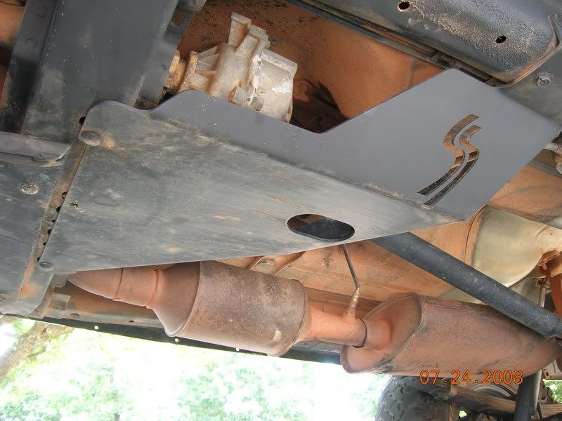

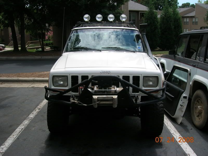

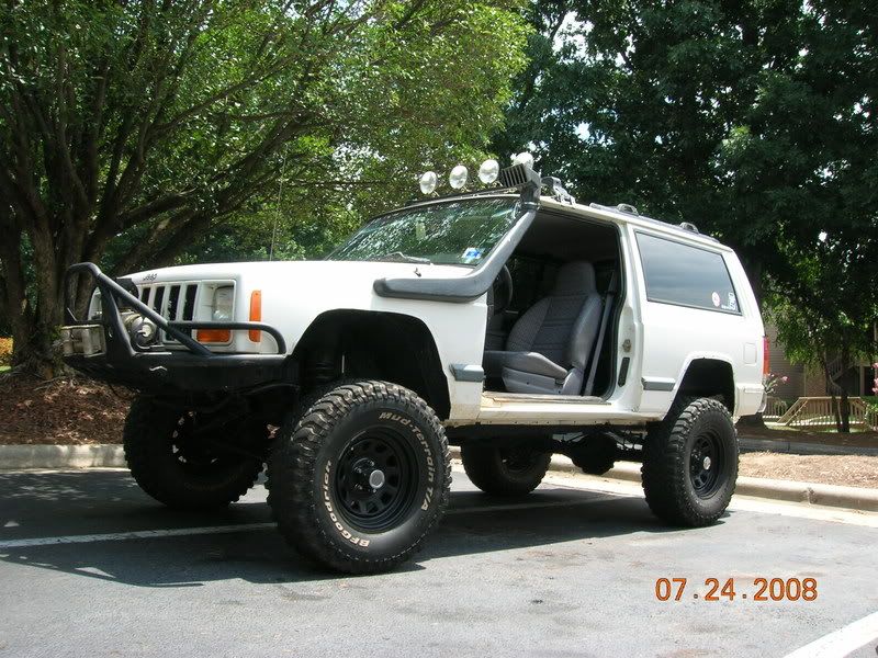

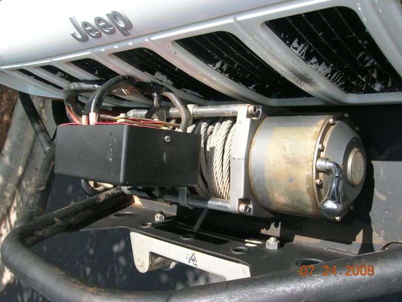

Okay i dont have pics from my original stage I build, but i will show you what it looked like during its first stage of modification...
4.5" rubicon express superflex
RE twin tubes
HP30 front, 8.25 29 spline rear... 3.07s
AX15
4.0L
white 2 door
skid row engine skid
skidrow tcase skid
TNT Rock Runner front bumper
CARR light bar, 4 lights
safari snorkel
15x8 d-window rims
32" BFG mud terrains
warn front diff shield
rear 8.25 diff shield
tmax 9k winch
SYE & t woods driveshaft
This is all stage I stuff, ill type up stage II in a second... just completed the second stage of my build.

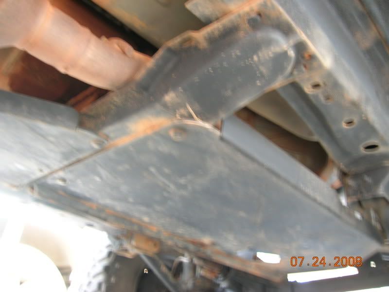

okay apparently i cant post pics? just links? Well whatever, i know run a 2" rubicon express rear block, 6.5" rustys front coils, 2" front puck (winch weighs the front down some). The whole truck is now at 7-7.5" of lift.
-8.8" rear axle out of any explorer (31 spline, disks, etc)
-riddler cover.
-35" tsl radial SSRs
-1" front spacers and 1.25" spacers make both axles about even
-JCR 1 ton steering (utk)
-4.10 geared front HP30 out of a 4 cyl XJ
-stock 4.10s in the 8.8 also
-also bought superflex adjustable lowers
-new RE1660/1665 track bar and bracket with extended 1" coupler for the extra lift
-RC drop brackets
It will be on a RK 3 link front soon, ill keep this thread posted.
my steering angles...
the 8.8 ready to kick some @$$
Brake line and breather tube setup...
gay @$$ pitman arm...
Pullin out a 4.5" lifted XJ on 33s, it was nice to see him get stuck and me glide through it, reminded me why i put these new tires on haha
my XJ and my friend JD's red cherokee, his name on here is Higgs98XJ....
a
Im prob forgetting some stuff, its going to be getting lockers soon. I think id rather focus more on swapping it into a new jeep than upgrading more stuff just yet, I would like a 4 door automatic, but the 2 door 5 speed serves its purpose offroad. critisize as you please, id like to improve it as much as possible
