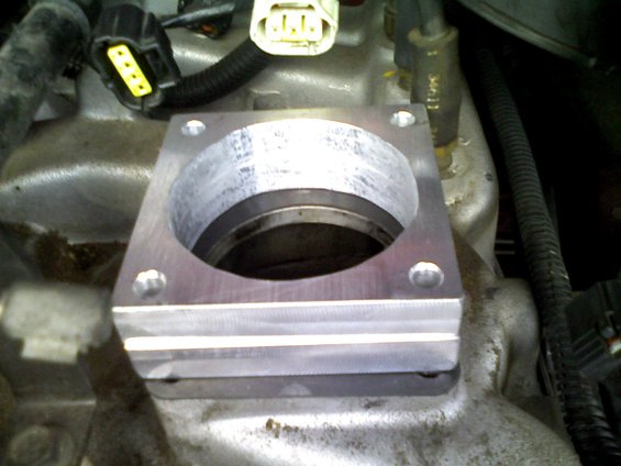

Did the throttle body from my 98 since the 94 one I did yesterday wouldnt work.
It came out great. Definately feel a difference with the bored TB and spacer. Little lag in shifting I guess from the added space into the intake and having to get the throttle shut and taking longer...
Here's some pics:
All bored out and clean:
Put back together:
Spacer on the manifold:
