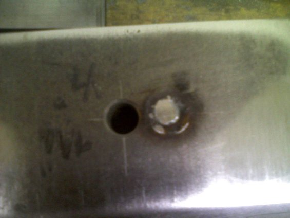

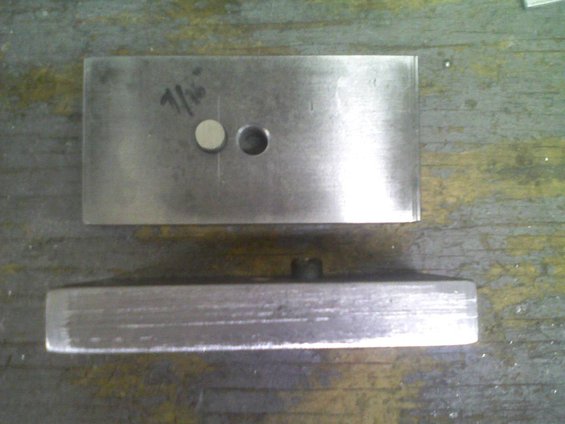

I made me some 3/4" zero rate blocks for the rear. And got some grade 8 U bolts from Rustys.
The zero rates are 9/16" offset that will shift my axle forward 9/16". I'm putting a 1 degree angle on them to help with pinion angle so they should net me about 5/8" lift.
Heres some pics:
They're going on this week or Saturday and I'll snap some pics and let you know how it goes.

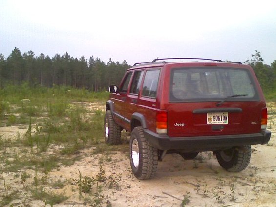

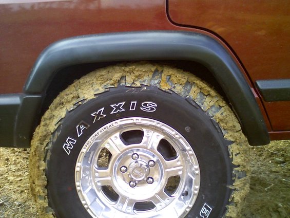

I ended up making them into 2 degrees. Also, they measure 11/16"ish. I put them on this afternoon after work but I was by myself for most of it and I didnt wannt stop to get the camera so I shot some test pics at the hunting club with the front sways off and checking to see if the the zero rate mover the axle in the right spot. Check it out.
Front of rear flare. Mud on the tires but not touching at all. Shocks bottomed out right there.
Back of rear flare. Not hitting anymore. Axles pretty well centered in the wheel well. I like it. Gave me 3/4" lift and leveled everything out too. Sitting at 21 1/2" rear 21 3/4''ish front. Basically the 4" gave me 4 1/2"(almost).

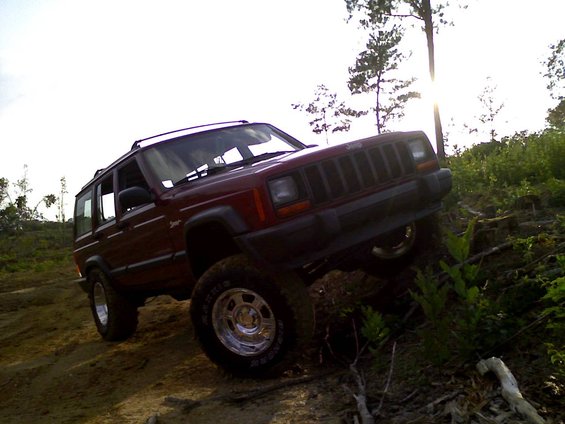

Few more showing how much more flex I got with sways off and adding a bit to the rear.

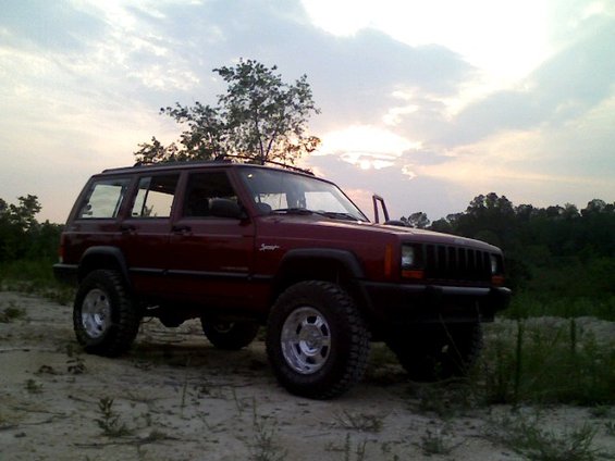

pics from little trails at the hunting club:
New sticker and took the CAGE one off the other side:
Shocks will be here Tuesday. Hoping the shackle will be before Saturday and if I can get Paypal to clear my money I should have the SYE before then too.
I'm at 22" in the front and 21" rear. I've got the 3/4" shackles on the way. That will put the rear up to 4 3/4" lift. What should I do on the front? I'm looking at making either a 1/2" spacer or 3/4". I'm going to get or make a front bumper soon and IDK whether to go ahead and go with something a bit bigger so a can commensate for any sag when the bumper is on or go with the 1/2" to just level it out?...Advice?
